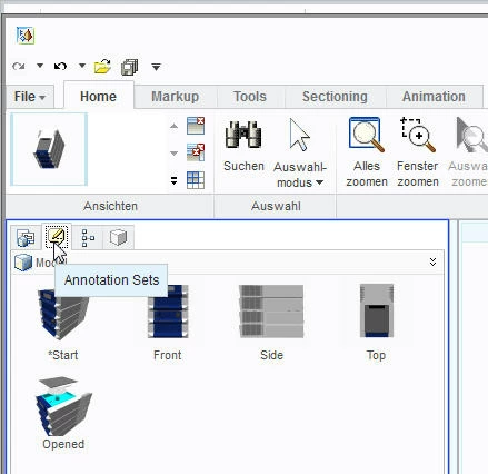

I am wondering if anyone knows how to export or create "annotation sets" in a pvz file.
I know that simpreps and/or combined states can be included in to CreoView (*.pvz) files bycorrect settings in the rcp recipefile. These are exported as "viewables" to the CreoView file and can be selected under the tab "Viewables".
I have a PTC demo pvz file which has some kind of "Previews" to states. These can be selected under the tab "Annotation Sets" in Creo View - see attached screenshots.
>> DOES ANYONE KNOW HOW TO CREATE THESE ANNOTATION SETS??? In Creo Parametric, Pro/E or CreoView Lite/MCAD ???

In CreoView do this:
1. select the markup tab
2. markup as needed
3. File | Save Annotation Set
