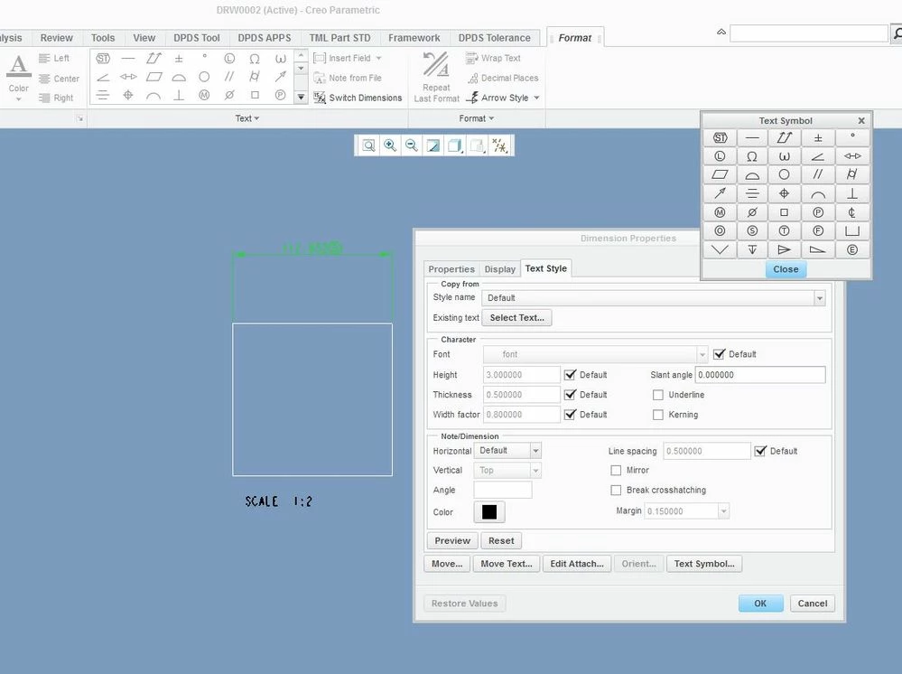

Currently we are facing problem to link or relate custom symbol to dimension, so i want to know, is it possible to add custom symbol in text symbol so while adding dimension these symbol also add and get link with dimension (no need to relate object differently). So if it is possible then pls share steps in detail or if not possible then another workaround to link custom symbol and dimension easily.

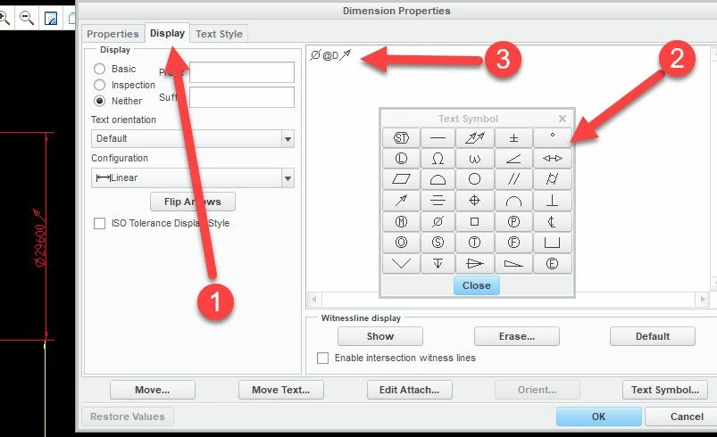

download Creo 4.0 Installation and Administration Guide - English using https://support.ptc.com/view?im_dbkey=171806 URL and read information on page 130, Customizing the Text Symbol Palette for Creo Parametric.

You must go to the "Display" pane.

Thanks for reply. Whatever shown in step 2 (text symbol) in that i want to add our new customized symbol.
So want to know, how we can add in this.
