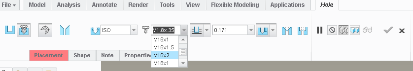

I require to state an M16 tapping size for a hole on my Creo drawing
Any ideas how to do this as I can only get up to M10 within the tolerance tables from model properties
Any help would be highly appreciated

Are you using the hole feature?

Steven,
If you are creating a Standard Hole feature, as indicated by Stephen's image, you will be able to show the Standard Hole Note in the drawing.
