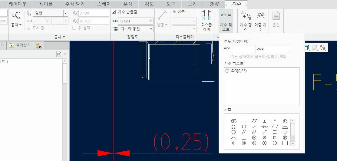

Hello Guys,
During the using Creo 4.0, I have some problem when I try to add tolerance after modifying dimension.
Tolerance is no appeared after I modify dimension myself. I want to add +0/-0.25.
How can I solve this..? Please support me.
Thank you in advance.

dkim-81-VisitorAuthor
November 21, 2019
Thank you for your feedback.
My problem is that I can see tolerance when I put it on real dimension. (ex. 1.3+0/-0.2)
But, I can't see tolerance after I change dimension personally. (ex. 1.3 -> 2.5 using the '@O 2.5')
http://support.ptc.com/help/creo/creo_pma/korean/index.html#page/detail%2FTo_Overwrite_Dim_Value_Display_with_a_Text_String.html
So, I want to put in tolerance even if I change dimension.

StephenW23-Emerald IIIAnswer
November 22, 2019
If you are just overwriting the dimension, then just add the tolerance as text using superscript/subscript.
Copy and paste this line in to the dimension text
{0:@O}2.5 {2:@++0@#}{3:@--0.2@#}
Why are you overwriting the dimension? In general, that is VERY poor practice.
