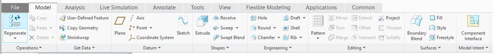

I'm don't think you can change the actual icon sizes but you can hide the command labels.
Before:
After:
How to hide them:

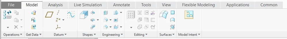

Contrary to what @TomU and @Mahesh_Sharma said, you can resize icons (you can switch between large and small version of the icon). To change the size of the icon, first right-click the ribbon and select Customize the Ribbon to display Creo Parametric Options dialog box. Then you can simply right-click desired icon and select Small Button or Large Button to set the icon size.
For example, all icons set to Small Button:
