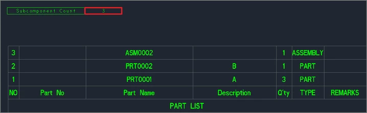

I am looking for a way to calculate the number of unique component types (excluding duplicates) in an assembly and automatically display this value in a drawing using parameters in Creo Parametric.
The goal is to achieve something like the red box in the attached image, where the number of unique components (e.g., ) is calculated and shown. If a part is used multiple times (e.g., the same part number), it should still be counted as one unique type.3
Questions:
  1. How can I create a parameter that calculates the number of unique component types in an assembly?
  2. What steps are needed to insert this parameter into a drawing?
  3. Are there any additional Relation settings or tips required to make this work?
Example Image Description:
  • The red box in the image shows where I want the number of unique component types (e.g., 3) to appear in the drawing.
I would greatly appreciate detailed steps or examples to help implement this. Thank you in advance!

I doubt that Creo can insert the maximum value of rpt.index into a drawing or model parameter.
Jan 14, 2025 8:44 AM UTC
I tried to apply it that way, but I failed.
Jan 14, 2025 9:47 AM UTC
that is obvious ... rpt.index is "visible" inside repeat region, only. Additionally, the model parameters are read-only inside repeat region.
Van_AG
Jan 14, 2025 2:18 PM UTC
Maybe using ModelCHECK in an assembly...?
There are ASM_BOM and UNQ_COMPONENTS checks.
You can parse ModelCHECK report and extract the check's values...
Jan 14, 2025 2:42 PM UTC
ModelCheck will give you this information:
UNQ_COMPONENTS
Number of unique parts and sub-assemblies: 281
ASM_BOM
Bill of material: 5346
StephenW
Jan 14, 2025 2:38 PM UTC
You probably have other reasons, but on this drawing, the balloon number (rpt.index) is that counter???
Jan 15, 2025 12:10 AM UTC
Yes I can mark the last rpt.index number over there.
