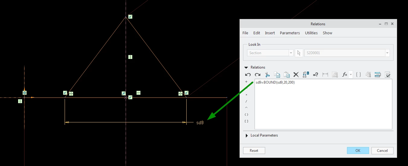

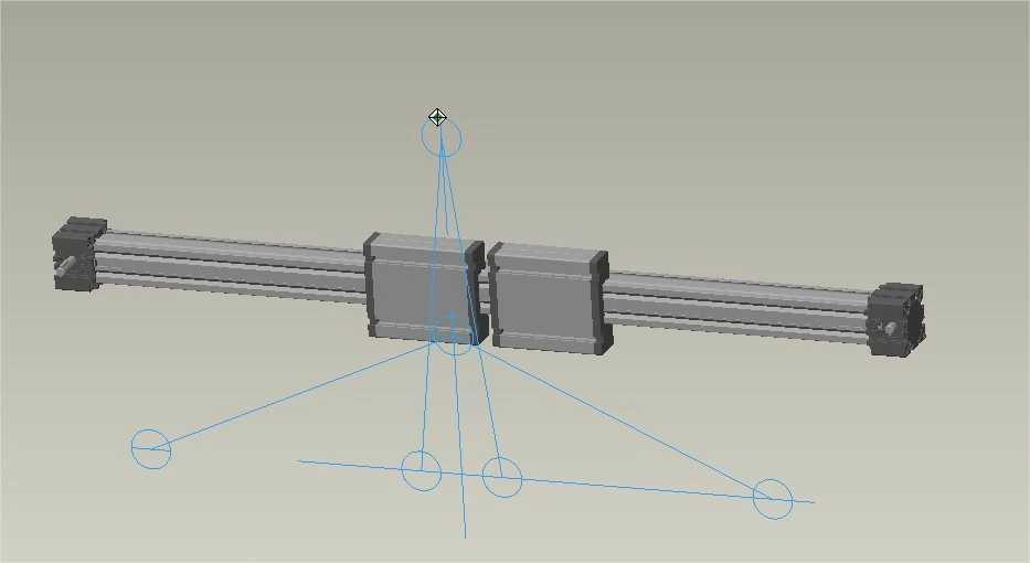

I am using a motion skeleton to create a symetric movement for a rail
see attached images.
like this, moving one part move also the other one.

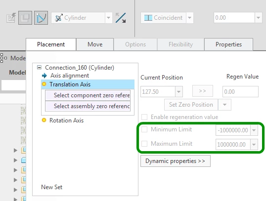

but I can 't find the way to "block"or control the amplitude, to have some limits mini, maxi.
I want to be sure to not have my parts touching.
