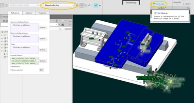

Yes, I think so (if I understand your ask).  Try this:
1) bring in the new sub-assembly into your master assembly.
2) activate this new sub-assembly
3) use shrinkwrap feature "Manual collection" option to gather the coordinate systems of the master assembly components:
tbraxton
Nov 16, 2023 5:32 PM UTC
If shrinkwrap works for this (it should) that is a good workaround to leverage your existing models. Shrinkwrap also provides for filtering what is referenced by the feature.
I probably would not default to using this as SOP without putting some thought to it. It is used in routed systems design to get relevant routing references propagated through the design space.
