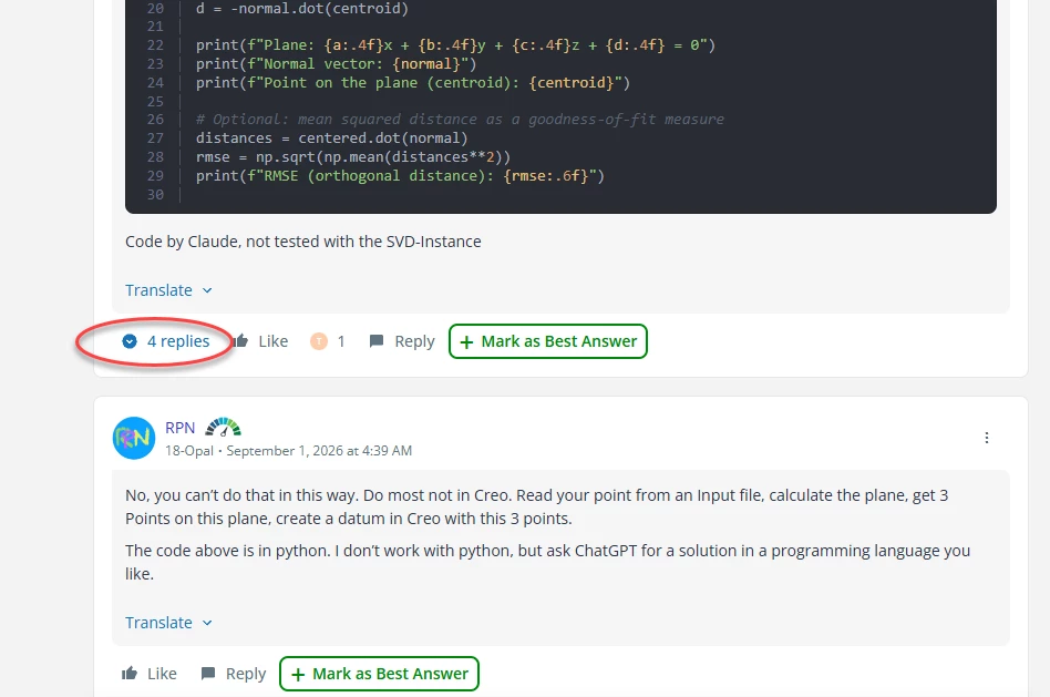

Can someone of the admins explain why this thread has not all messages here!
Some answers are definitely no longer listed, why? Is it buggy here?
StephenW
Sep 2, 2026 10:10 AM UTC
​@RPN  The new community provider auto-collapses (if that is a real thing) multiple replies to a post. You have to watch for the “x replies”  under a post to see if  has collapsed them.
RPN
18-Opal
Sep 2, 2026 8:20 PM UTC
Thank you 🎊🎈🪅, so minimum 2 people stumbled over the new feature 😅
And what is the reason that sometimes you can give an answer on every item, and sometimes not one at all😅
