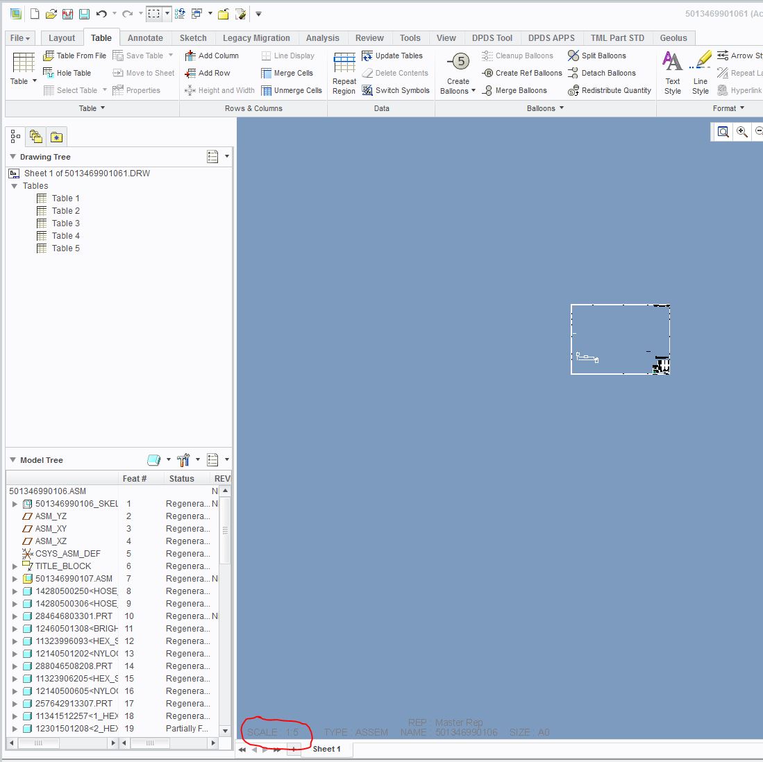

Hi..
I want to change scale of my drawing through mapkey but the command is not getting recorded it needs manual selection.
so is there any command instead of highlighted below. OR
is there any other option to change drawing scale automatically through mapkey.?

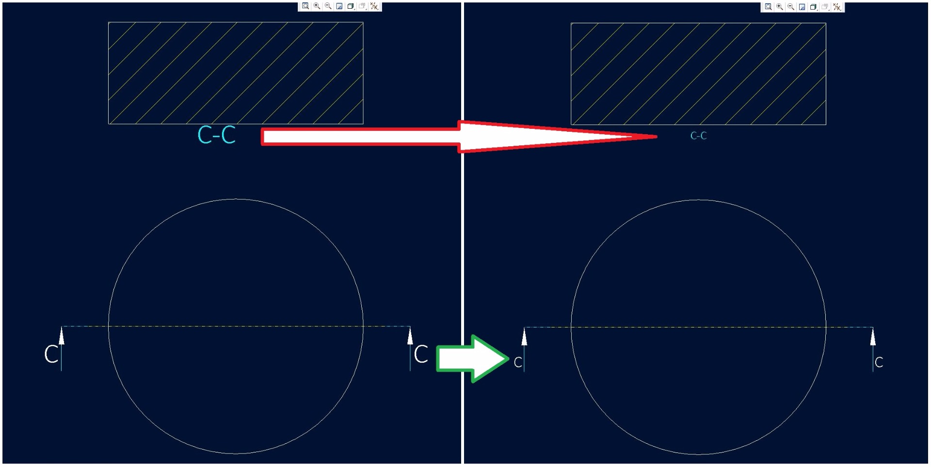

Hello prashant pandarkar
some macros in drawing space need "item preselection". See attached picture and config.pro with macros. l use this macros to change font size of X-section labels.
It needs to "preselect item" where will be macro applied.
Haven´t tested your idea with drawing scale. But maybe there is similar "problem".
Just try to "preselect" drawing scale in left bottom corrner inside drawing space and than apply your macro.
Regards
Milan
