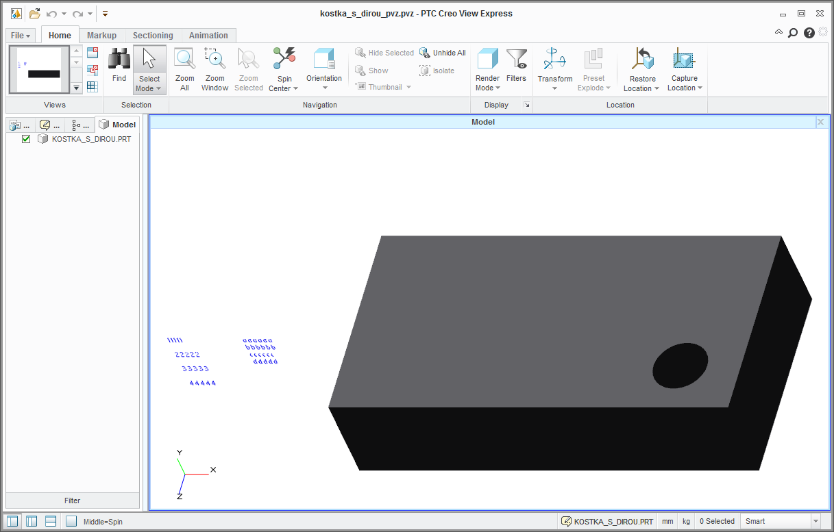

When I set scale of view as 1/3 for example, in representation it shows 133/400. How do I make sure that whatever format i enter the scale; the same is represented?

llie17-PeridotAuthor
March 14, 2017
All,
The image is from an MBD model doing a File, Save AS, .pvz in Creo Parametric 3.0 M070.
We get the same results from the CAD Worker when we publish during check-in of the file to Windchill.
March 15, 2017
I tested CR3 M100, CR3 M120, Creo View Express 3.1 F000.
Left annotation was just created in Creo (not edited).
Right annotation was created and then edited (empty lines added by Creo were removed).
I think the problem is related to CS241113 mentioned by Brian Toussaint
Please open Case at PTC Support and report the problem.
