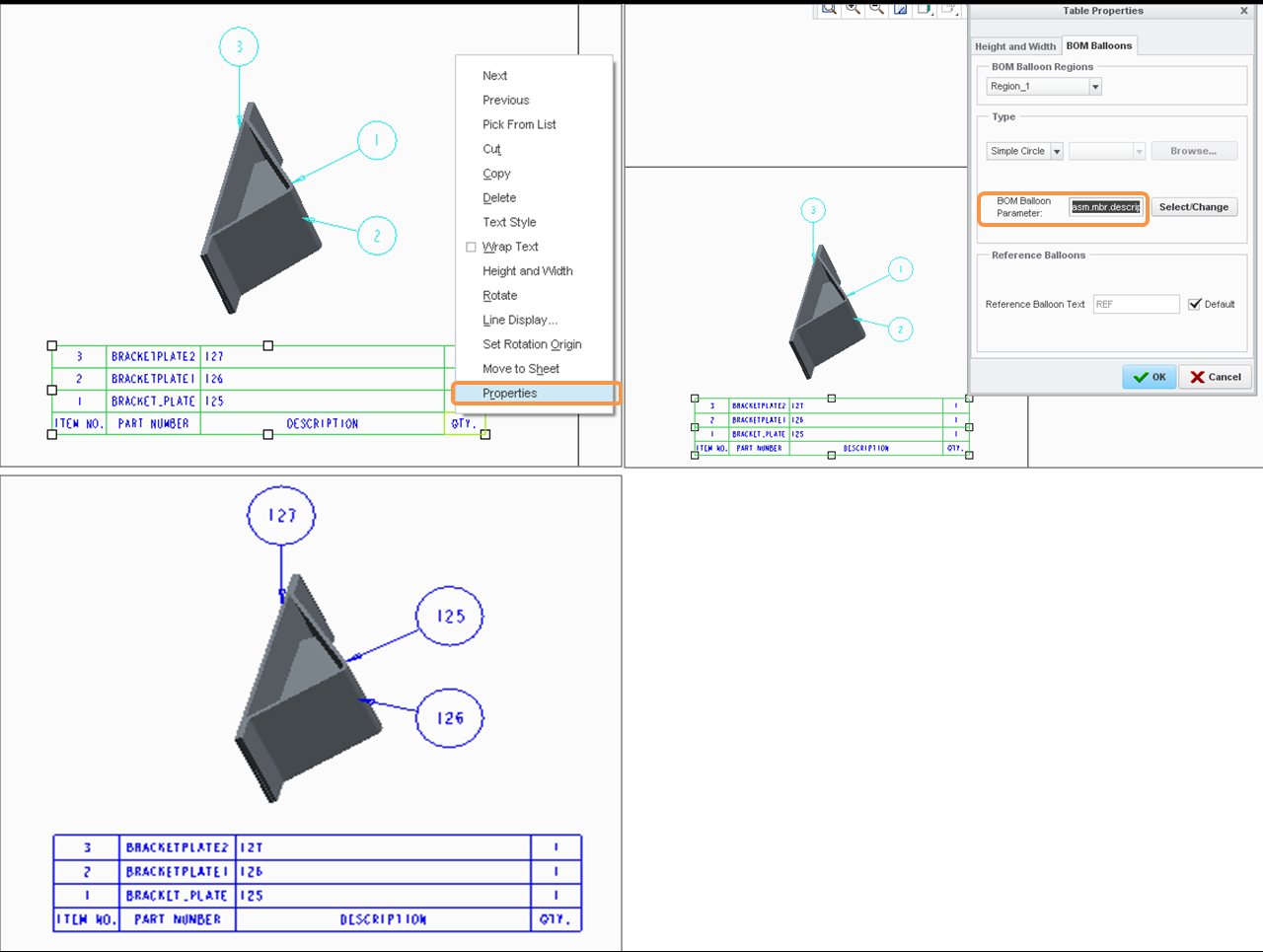

Hi all!
can anybody help me on query in detailing?
I was previously working with Pro/E wildfire 5.0. in widfire 5.0 after creating a table containing part_no parameter associated to the assembly member name.
default balloons created are coming with serial no. i.e 1,2,3,4,...... like wise.
but my problem is, I want balloons containing part_no which i have given to that parts. Previous wildfire 5.0 was able to do that by altering the parameter of balloon. option was given in menu manger it self
but now in Creo 2.0 there is no such menumanger option in balloon creation from table. so how can i overcome with the problem?
Can any body knows wat actually to do for the same with Creo 2.0?
is anybody facing the same problem?
pls mail me the solution on my mail id:- - or you can answer here in the discussion....

Hi
1.Create the default bom ballons
2.Select the table >right click>properties
3.Change the BOM Balloon parameter to asm.mbr.<parameter>
in your case it would be asm.mbr.part_no
4.press OK and check the Updated BOM Balloon
Regards
K.Mahanta

To all, I finally figured out how to do this, but one small issue. You cannot split the balloon once the rpt.rel.qty report symbol is used in the custom balloon. I dont think there is any way around this.....
