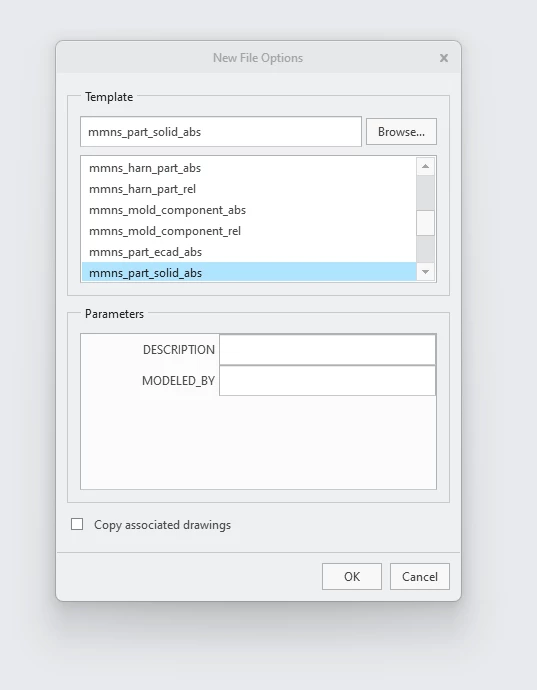

How to change the default template?
Where can I go to change the default template?
Hi @ENGINEERINGXYZ,
You can use the below config.pro options to change the default templates:
  • Set template_solidpart to point to a part file (*.prt) : Specified part will be the template when creating new part
  • Set template_sheetmetalpart to point to a sheetmetal file (*.prt) : Specified sheetmetal part will be the template when creating new sheetmetal part
  • Set template_designasm to point to an assembly file (*.asm) : Specified assembly will be the template when creating new assembly
  • Set template_drawing to point to a drawing file (*.drw) : Specified drawing will be the template when creating new drawing.
For more information refer to the article CS30130.
