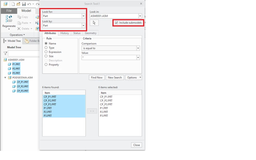

tip: To select parts, you can use Search Tool (binocular icon at the bottom of Creo window).

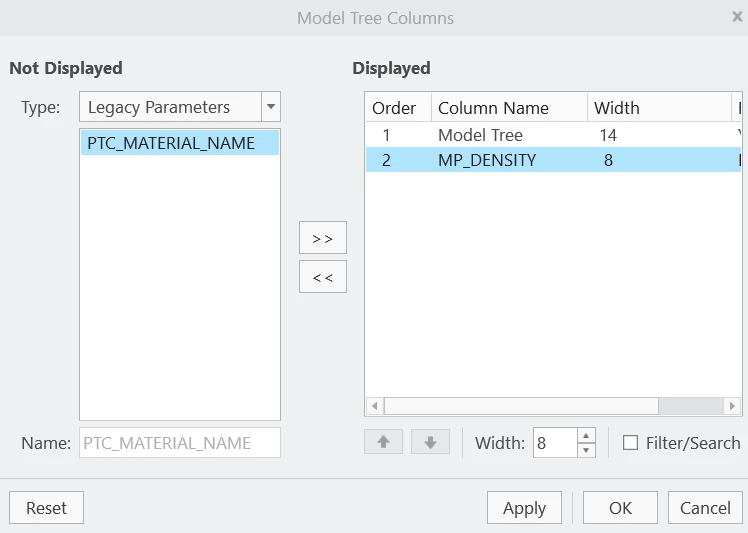

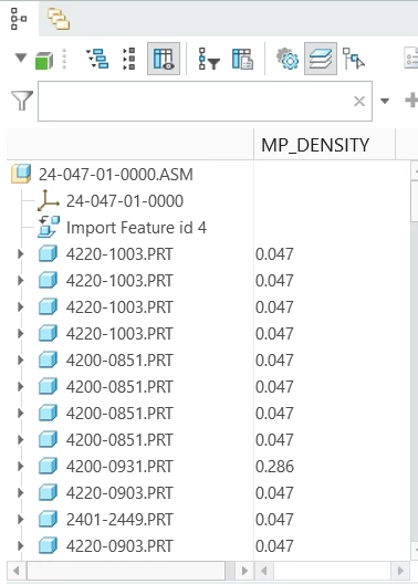

Sep 29, 2026 6:21 PM UTC
As an alternative, perhaps easier method, just simply add the parameter “MP_DENSITY” as a column to your family tree. All density values can be entered/modified directly from the family tree. FYI, when adding the column, at least within Creo 12, MP_DENSITY will be listed under the “Type” of “Legacy Parameters”.
Sep 29, 2026 9:22 PM UTC
Sorry, I meant to say “model tree”, not “family tree”!
