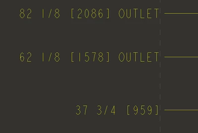

How to change the fraction format in a drawing?
Is there any config.pro or .dtl settings to change the format of the fractions?
see below for example the default is 4-3/8 I want to change to  4 3/8. or 4  3/8(double space depending on the fonts I am using)

it can be changed by changing "dim_fraction_format" to AISE.

To the best of my knowledge this is not possible. Seems that the only config.pro options that let us decide fractional variants are:
create_fraction_dim  -> "yes" means all dims as fractions, "no" means they're all decimals
dim_fraction_denominator -> sets the largest denominator of the fraction parts of dimensions
dim_fraction_format -> "Std" means standard Creo, "Aisc" means use architectural feet-inch format
use_major_units -> some sort of weird esoteric setting for use of "retrieval of pre-Creo solids"?
Perhaps someone with more tricks than me might have a way to do this, but I don't think so.

Hmm. That must be a "hidden" option. When I look at the possible settings for dim_fraction_format I only see "std" and "aisc" for which the description is:
Std - Displays fractional dimensions in the standard Creo format. Aisc - Displays fractional dimensions in the American Institute of Steel Construction (AISC) format and displays architectural units in AISC format for feet-inches.

I think that was a typo AISE should be AISC
It works.
You do have to also pay attention to the option Use_major_units also. If this is set to yes, it will show in Feet-inches
