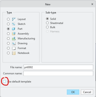

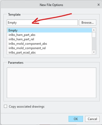

Dec 5, 2024 9:12 PM UTC
Does the same happens if you start with a completely blank part?:
