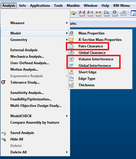

I want to check which component having clearance or interference while assembly.
So please can I know, is there any modelcheck option available or another method. ?
Prashant Pandarkar
August 17, 2015
ProE Analysis are:
Note: it is not possible to chceck by ModelCHECK (I do not know any similar option in MC)
