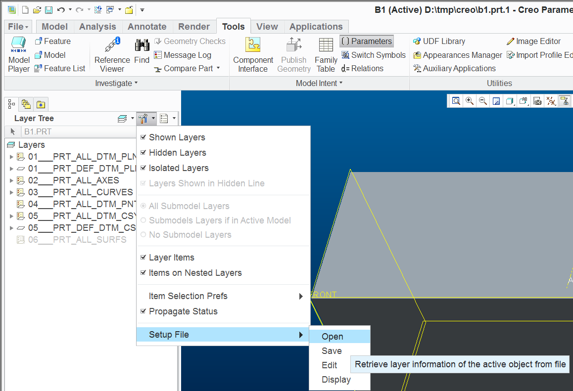

I am also interested in this answer and would like to take it one step further, if I may...
Once determined positive to layer compliance; how to change the layers setting, if need be, to the proper status (visible/hidden)?
Ron
Jun 11, 2015 1:03 PM UTC
Ron,
you can create layer status file (using Save command) and later load it (using Open command).

Jun 11, 2015 1:15 PM UTC
Martin,
Thank you.  I do have this portion implemented - I think.
I have mapkeys that will fix our legacy files to comply to our "corporate standard".
I can fix the parts but it is going to be more difficult to fix the operators so I need to do this automatically - hopefully thru model check.
What I am looking for is, after an operator does work, that the structure be set back to standard should the operator make modifications to it.
I think Don provided some vital documentation I need to read - and I do appreciate any and all help.
ron
