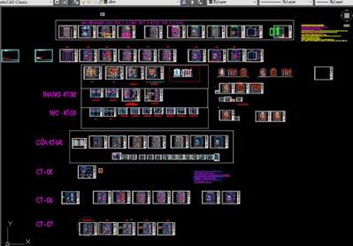

How to combine/merge multiple drawings into a single drawing file
As autocad. I have many 2D drawings, each drawing is a .DWR file. Is there any tool in the Drawing interface of Creo 12 to quickly combine many drawings into one DWR file? Thanks

My company is only using Creo for 2D and 3D, So, I need to check as My customer AutocCAD Drawing sending

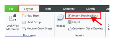

Procedure of "merging" Drawings
1. Open a drawing.
2. Click Layout >
Import Drawing/Data. The Open dialog box opens.
3. Select the source file to merge into the current drawing. When you select a file, the source file is merged into the current (target) file.
4. Select additional source files to be merged, one at a time, to add additional sheets to the current drawing.
