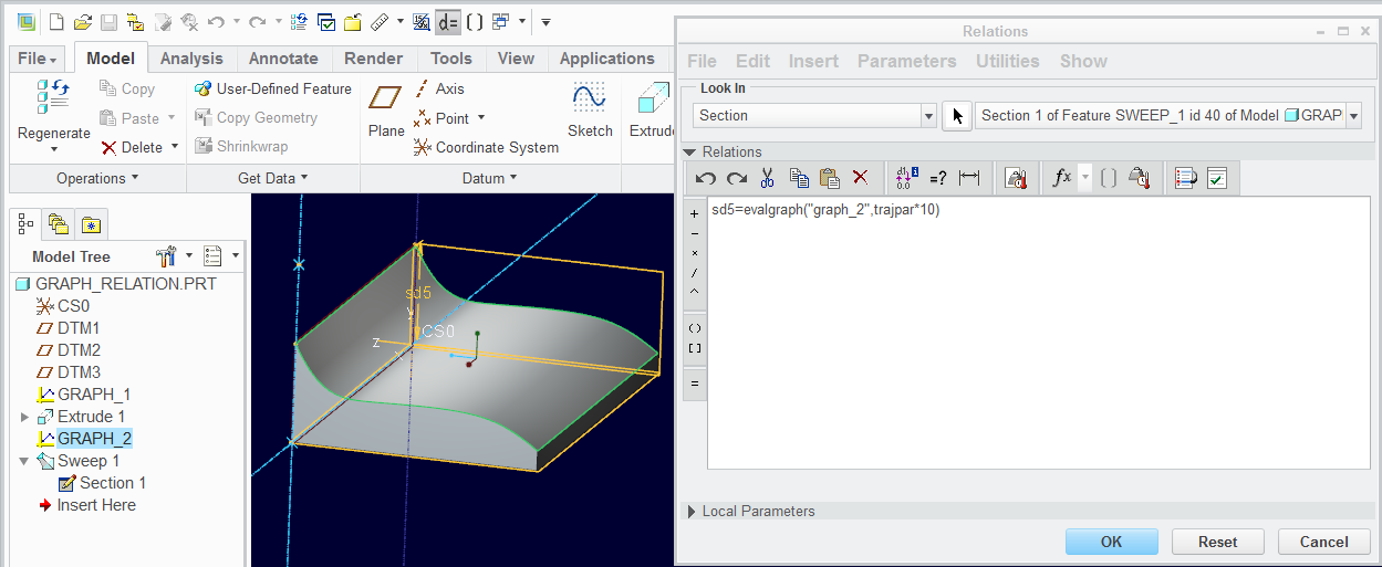

I want to draw a sketch that I will use for a sweep that I want to constrain to a nominal number (probably 41 or 42"). The sketch will be a variety of lines and arcs (tangent to the lines). The actual nominal number is not important (can be anything). And the variable pieces mostly are not very important either, just fitting it in the space I have is the only real constraint.
What is a good way to do this?
thanks
Best answer by Patriot_1776
I'm confused......do you want the overall LENGTH of the trajectory to be 41 or 42", regardless of the make-up (arcs/lines, etc.) of the trajectory? If so, you'll want to use the perimeter option in sketcher.

I can't picture this, Matt. I suspect you have two answers; relations built from the sketch (perimeter dimension relation?) or a trajpar relation in the swept sketch. Trajpar is a value from 0-1 along the trajectory (open sketch) or 0-360 (closed sketch) in relation to the origin sketch.

You might also look at the graph option. This is also a value driven by relations, but the relation is a graph. You can then be very specific about changes in the variable section sweep.

YES! that worked perfect, thanks.
