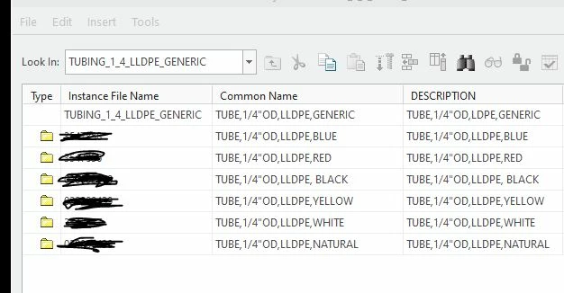

I want to assign different color for each family table instance. is there a way to do this? pls suggest.

These are existing models available in Windchill. Refer attached image for the family table structure.

Sorry, we are using material as "PURCHASED" for BOM purpose for all the instances which we don't want to change.
