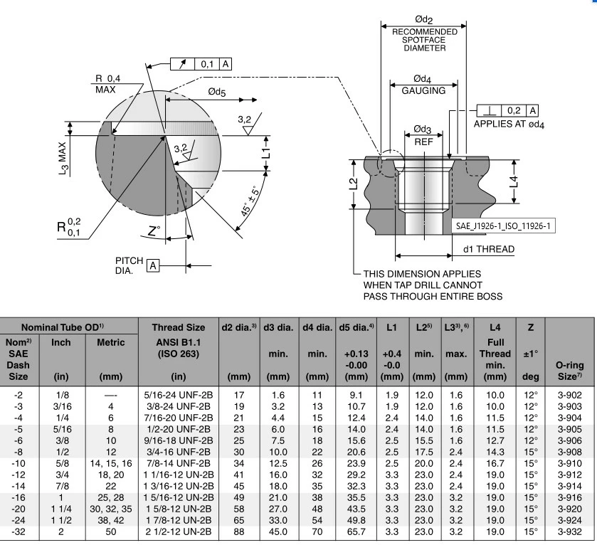

Hoping someone can point me to some info on how or if a sketch hole could be used to create a custom hole definition?
I know how to change the .hol definition to change the text and called out format for all holes.
Need info on how to create a new hole shape with out sketching it every time.
I would like to create standard hole definitions for SAE J1926 tube fiting ports and have the hole automatically modeled correctly when the holes are placed for various sized fitting ports.

You may want to try the UDF in this post. https://community.ptc.com/t5/Creo-Modeling-Questions/Port-UDF/m-p/239895
I haven't tried this particular one but I have used UDFs for this application.

Trying to stay away from using UDF's to make it quicker to switch hole types in a part along with making it easier to update the patterns.  Right now I can load the different sketches using the hole sketch command and would like to automate the selection process for creating holes and call-outs for drawings.
Thank you for that option!
