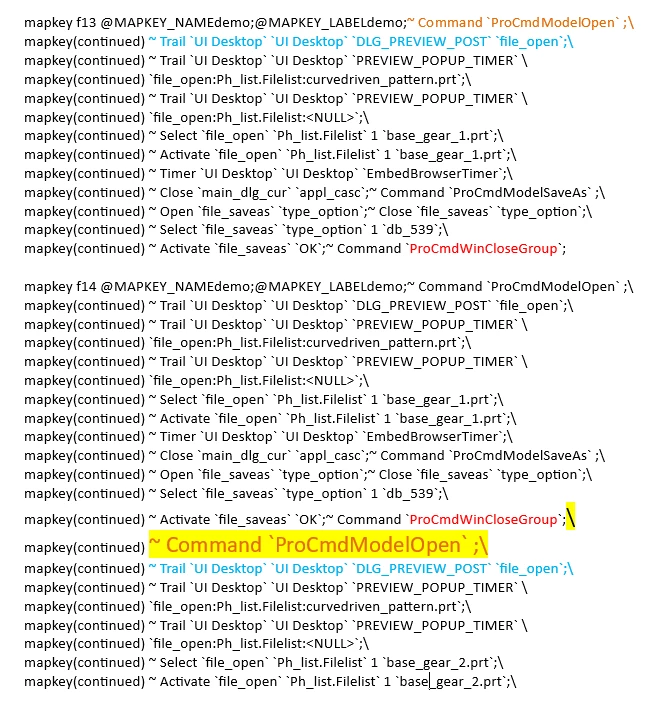

How to create a nested/multiply mapkeys? Why it is not working?
I created a Mapkey just to test, to open a .prt and save as .stp and close
mapkey f13 @MAPKEY_NAMEdemo;@MAPKEY_LABELdemo;~ Command `ProCmdModelOpen` ;\
mapkey(continued) ~ Trail `UI Desktop` `UI Desktop` `DLG_PREVIEW_POST` `file_open`;\
mapkey(continued) ~ Trail `UI Desktop` `UI Desktop` `PREVIEW_POPUP_TIMER` \
mapkey(continued) `file_open:Ph_list.Filelist:curvedriven_pattern.prt`;\
mapkey(continued) `file_open:Ph_list.Filelist:<NULL>`;\
mapkey(continued) ~ Select `file_open` `Ph_list.Filelist` 1 `base_gear_1.prt`;\
mapkey(continued) ~ Activate `file_open` `Ph_list.Filelist` 1 `base_gear_1.prt`;\
mapkey(continued) ~ Timer `UI Desktop` `UI Desktop` `EmbedBrowserTimer`;\
mapkey(continued) ~ Close `main_dlg_cur` `appl_casc`;~ Command `ProCmdModelSaveAs` ;\
mapkey(continued) ~ Open `file_saveas` `type_option`;~ Close `file_saveas` `type_option`;\
mapkey(continued) ~ Select `file_saveas` `type_option` 1 `db_539`;\
mapkey(continued) ~ Activate `file_saveas` `OK`;~ Command `ProCmdWinCloseGroup`;
but I have some other files needs the same operations. so i copy in a notepad, multiply find and replace and did this

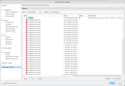

 and i got error like this.
is there any way to fix this?
Please see the attachments as my config2 is working but config3 is not. WHY?

Chris3
The red circle with a line through it means that line of the mapkey was not read in correctly. This is often because there was a misplaced or forgotten ending \ or ; character somewhere. You can look at the value column to understand what line if your code the mapkey is failing at and then try and troubleshoot it from there.
I didn't look though your config but it seems that you have extra lines in your mapkey that are not needed. It appears in your original mapkey you had curvedriven_pattern.prt highlighted and then deselected it. There is no reason to keep repeating this over and over. Try this:
From:
mapkey(continued) ~ Command `ProCmdModelOpen` ;\
To:
mapkey(continued) ~ Input `file_open` `Inputname` `base_gear_1.prt`;\
mapkey(continued) ~ Update `file_open` `Inputname` `base_gear_1.prt`;\
In the future it is better to paste in filenames and paths into the file open dialog box rather than picks with the mouse.
mapkey f14 @MAPKEY_NAMEdemo;@MAPKEY_LABELdemo;~ Command `ProCmdModelOpen` ;\
mapkey(continued) ~ Select `file_open` `Ph_list.Filelist` 1 `base_gear_2.prt`;\
mapkey(continued) ~ Activate `file_open` `Ph_list.Filelist` 1 `base_gear_2.prt`;\
mapkey(continued) ~ Select `file_open` `Ph_list.Filelist` 1 `base_gear_3.prt`;\
mapkey(continued) ~ Activate `file_open` `Ph_list.Filelist` 1 `base_gear_3.prt`;\
mapkey(continued) ~ Select `file_open` `Ph_list.Filelist` 1 `base_gear_4.prt`;\
mapkey(continued) ~ Activate `file_open` `Ph_list.Filelist` 1 `base_gear_4.prt`;\
mapkey(continued) ~ Select `file_open` `Ph_list.Filelist` 1 `base_gear_5.prt`;\
mapkey(continued) ~ Activate `file_open` `Ph_list.Filelist` 1 `base_gear_5.prt`;\
mapkey(continued) ~ Select `file_open` `Ph_list.Filelist` 1 `base_gear_6.prt`;\
mapkey(continued) ~ Activate `file_open` `Ph_list.Filelist` 1 `base_gear_6.prt`;\
mapkey(continued) ~ Select `file_open` `Ph_list.Filelist` 1 `base_gear_7.prt`;\
mapkey(continued) ~ Activate `file_open` `Ph_list.Filelist` 1 `base_gear_7.prt`;\
in your f14 mapkey some information is missing. See area with yellow background.
