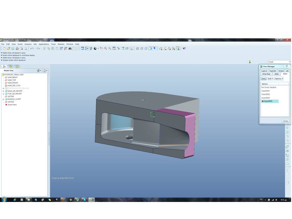

Hi!
I need some help on below:

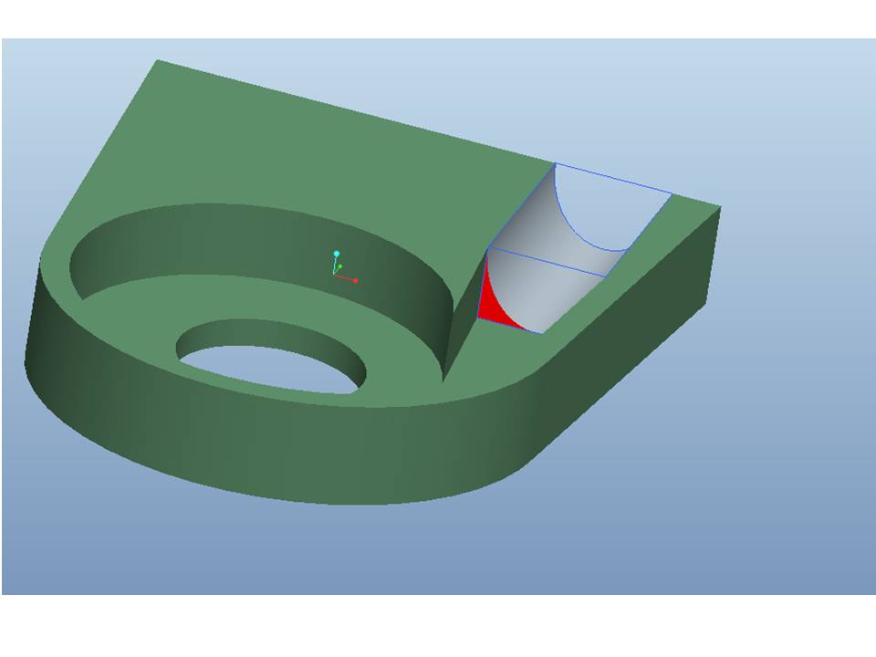

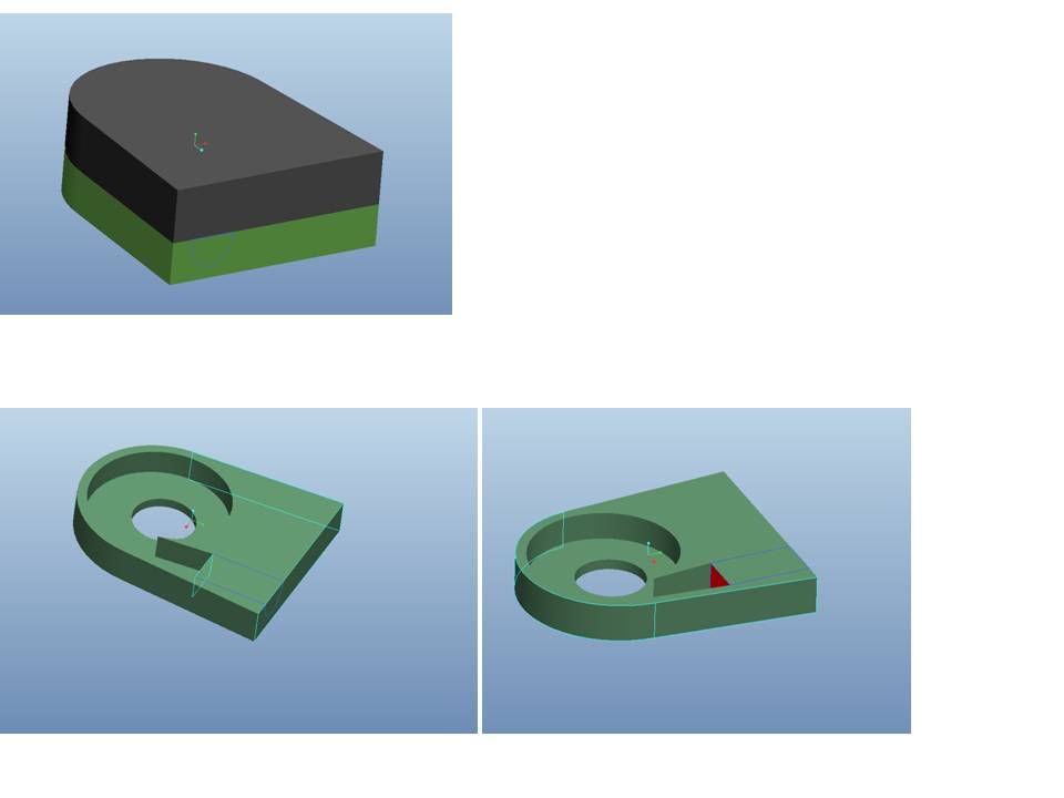

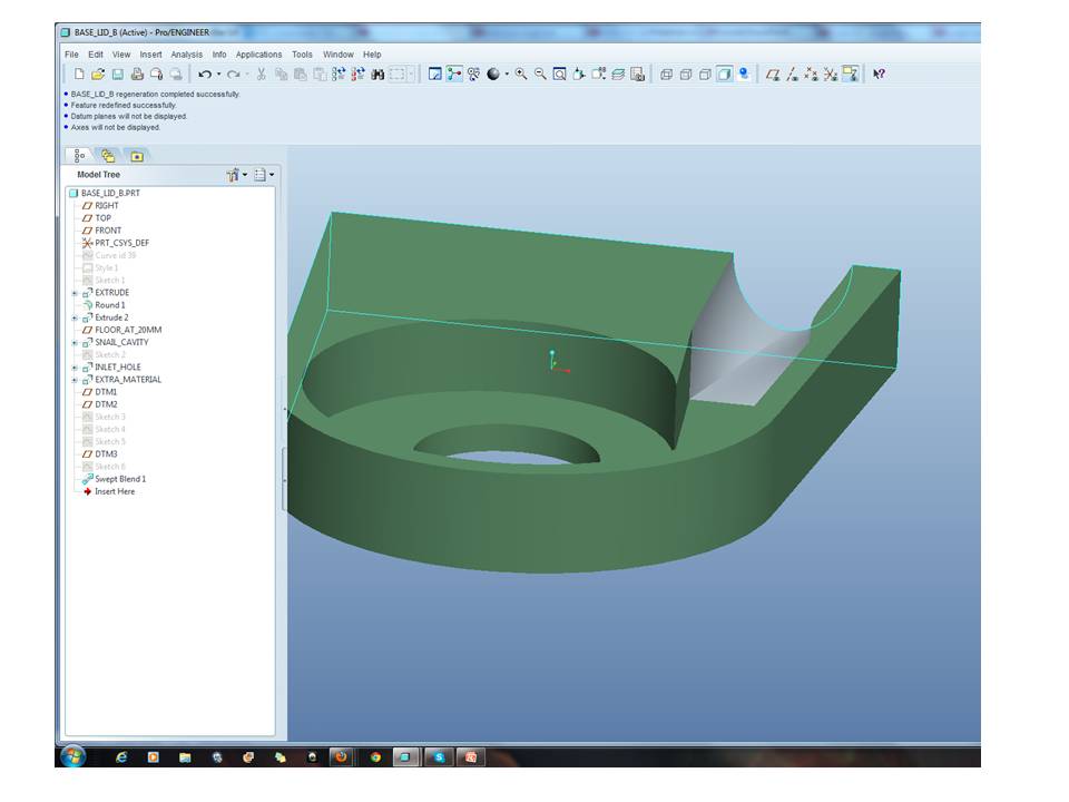

I am working on a plastic casing that has two main components as shown in the very first picture. There is already an inner cavity (turbine shaped cut to accept water) that ends to a rectangular opening. Client asked me to add material and extend this nozzle so that in the next 15cm to turn into a circle or ellipsis of same area.
In other words, we need to cut a almost tubular nozzle, which starts as rectangular and ends smoothly as circle or ellipsis.

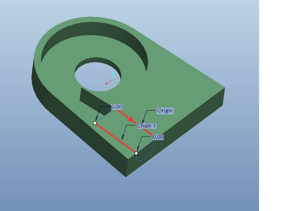

Pls see in red above, the rectangular surface where removing material should start.

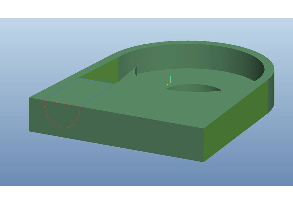

Since the ELLIPTICAL OUTLET OF NOZZLE should be created by the assembly of the two parts, we need half of the cut at each part.
That is why I have sketched a curve on the surface that we be removed to have it a refererce.

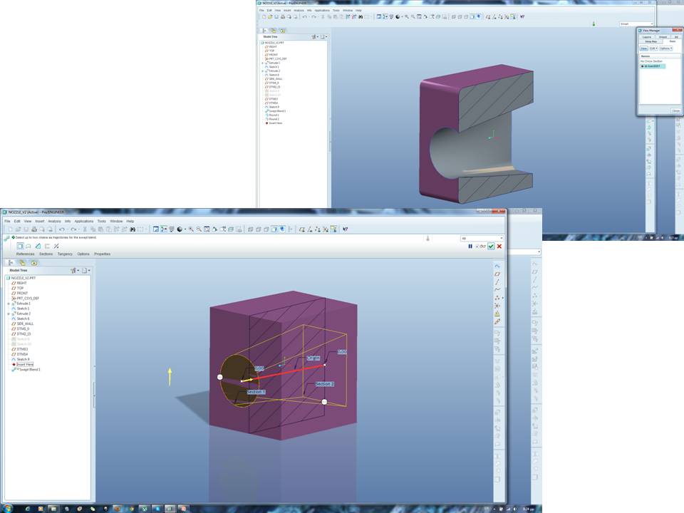

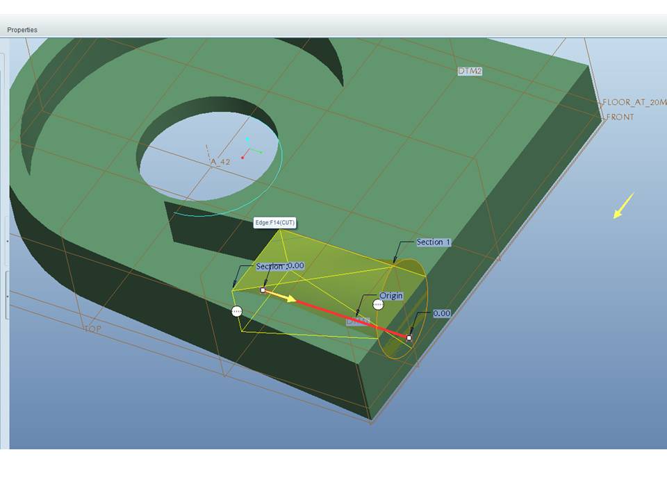

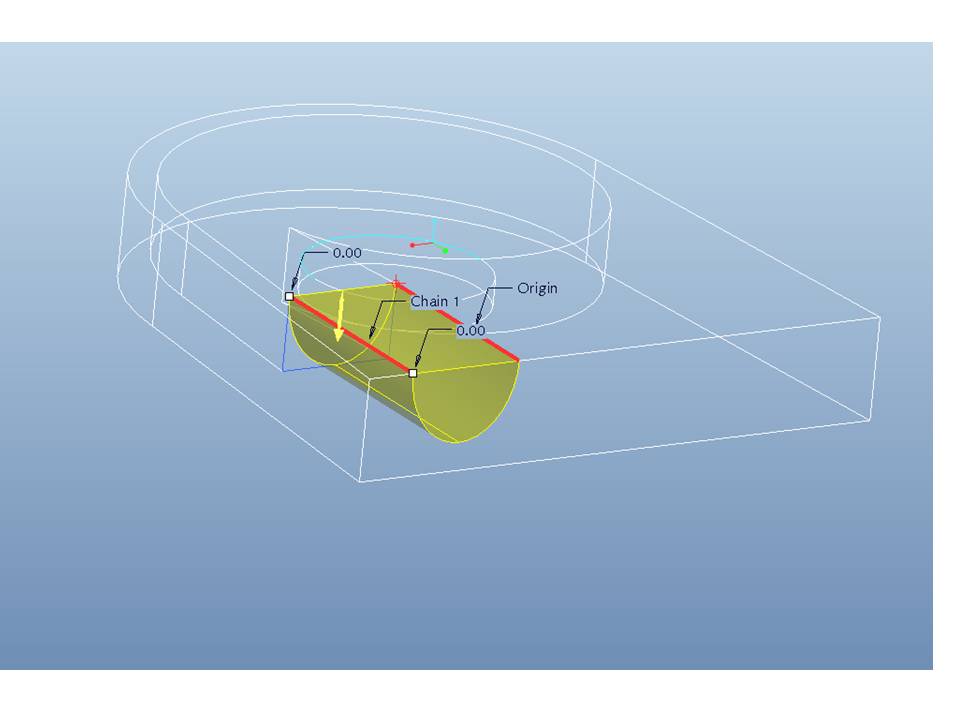

I tried Variable Section Sweep , with two trajectories that lead from the rencangular to the hald-ellipsis shape and I sketched a half ellipsis section.
And I get this:
which of course is not variable section cut, but only one section.
This cannot give me a smooth trancation for rectangular to elliptical opening.
Any advise or amendment to my thought?
I am not very familiar with variable section sweeps but I think there might be an easy way that I just dont know.
Please help me , the soonest the better. I m in despair!

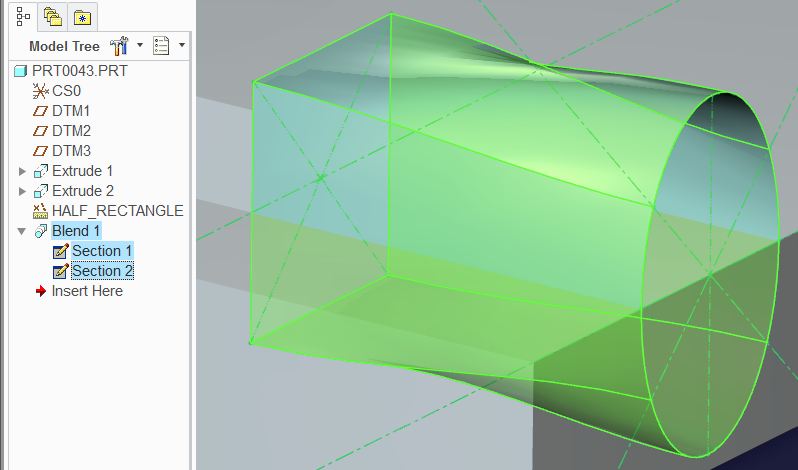

And just for completeness, I took this to the next level and added tangency to the tapered surfaces. Since I was using the "full" section, I needed a surface to define one of the tangencies (blue surface on top). Now the rectangular end is tangent to all 4 faces entering the rectangle and all the transitions are smooth.

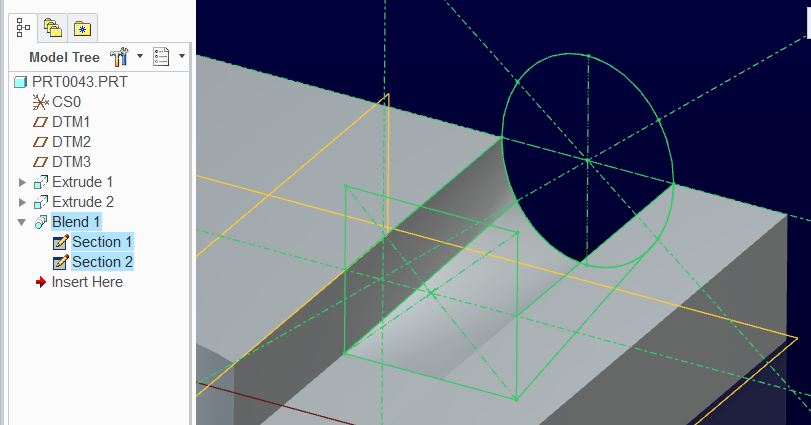

You just need the same number of segments in each sketch so you may need to break up the ellipse in the right locations. There is also no need to make only half the feature since it is a remove material feature.
I'll give it a try but that is the jest of it.
February 25, 2013
Yep, that works. Simplified version:
The crossed centerlines are used to define the ellipse "break point" by using "Divide" in the editing group/
You can control the ellipse in one of many way. Just know that a divided ellipse becomes a handful to manage as they now require constrains for each segment.
You get the options to make the ends straight, smooth, or tangent, etc.
This should all work the same way with blend in your version.

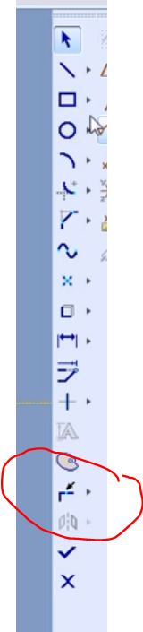

I am trying to understand what do you mean by dividing ellipse!
I have to draw also in sketch the crossed centerlines in order to get them as entities?
and what is the " divide " in "EDITING tree" ?! I need to go to the model tree and select any "divide" option?
I need a hint please!

You have "divide" in your WF5 sketcher... 4th button up from the bottom.

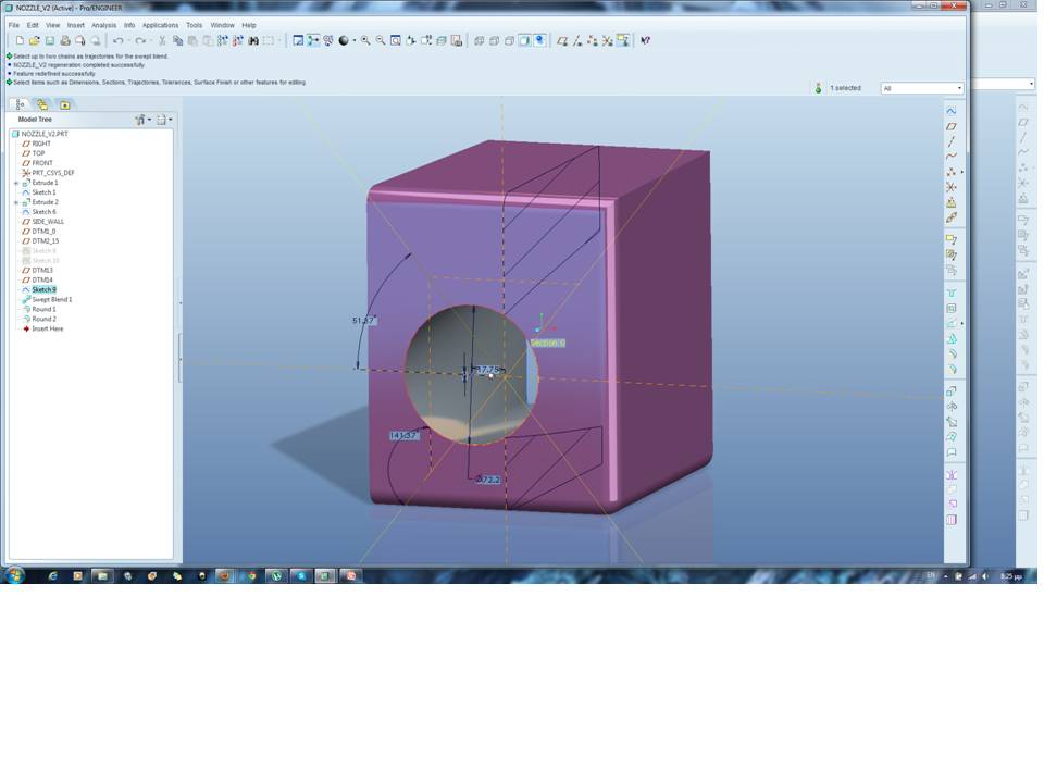

Ok, I broke the ellipse into 4 segments, so it was accepted to get together with the rectangle.
However, it is not a smooth transaction. Somehow ti TURNS/TWISTS in the inside and gives me no option to make it straight.
Have I missed sth?
February 25, 2013

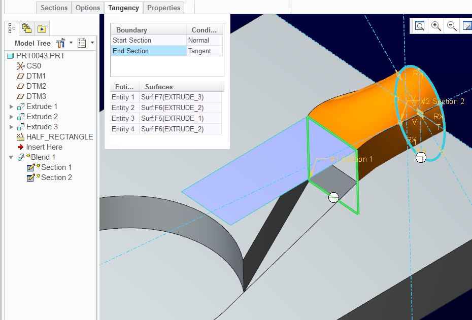

... yep, you have to control where those breaks are.
I added the "smooth" and "normal" tangency to the feature's ends and ended up with this (shown uncut for clarity)
Look where the transition lines go to:
Now you see why the centerline were included.
February 25, 2013

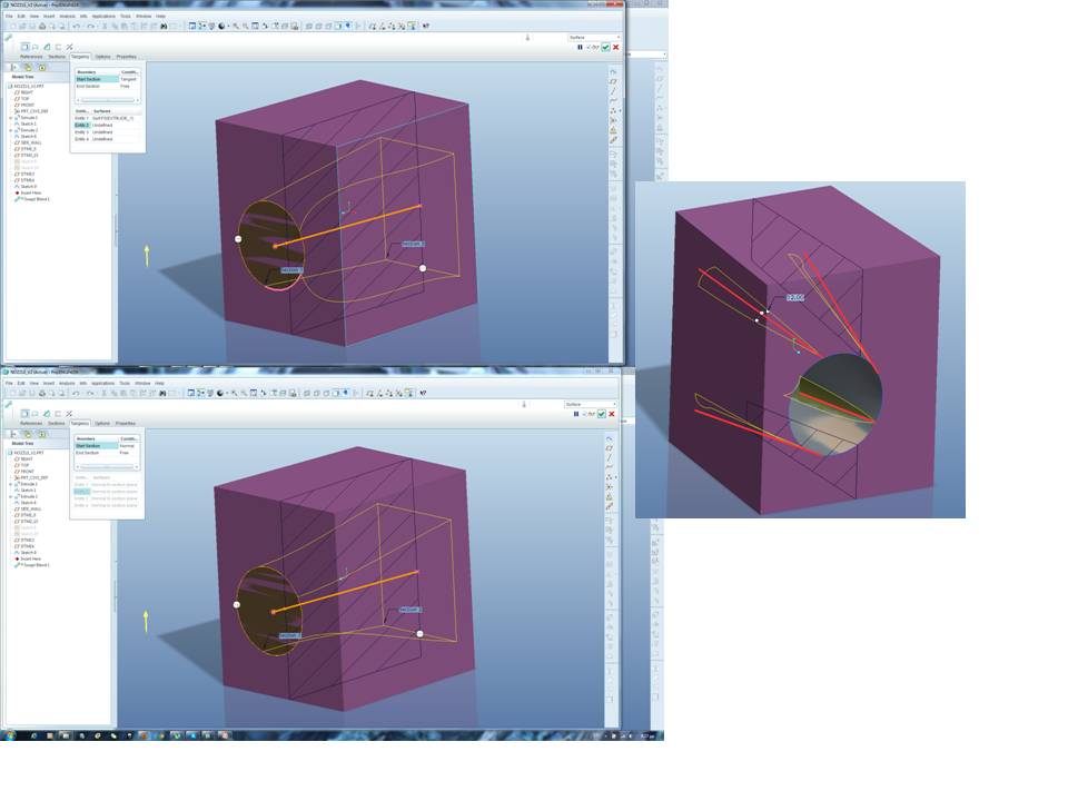

I have applied finally Swept Blend, with just 2 section at a 15cm transaction.
I chosen free ends for both sections, as tangent and normal created an unwanted curvature.
Then I applied a smooth radius.
I am not 100% satisfied yet. An other idea was to remove material gradually, every 10mm or 15mm distance, so as to have abt 15 sections and blend by pair. But that was worst, as the small distance create a strong twist of edges.
This is the final nozzle, as assembled to the basic turbine casing.
Thanks all for your advise.

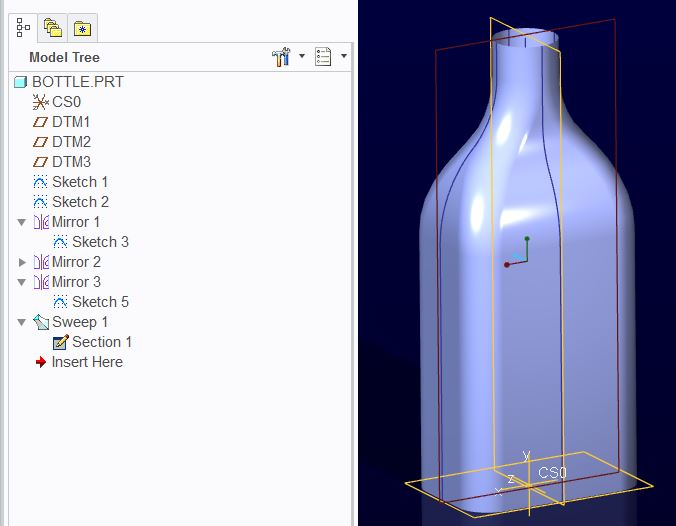

Often multiple sections lack the smoothness desired. If a particular path must be followed, guide curves in a variable section sweeps are more useful. One of PTC's knowledgebase examples is the bottle which is very similar to your "challenge".
Have you been following our discussion on the surface feature? I learned a lot about how to use the sweep feature in this discussion: http://communities.ptc.com/message/198441#198441
