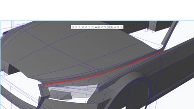

Hello. I model a car with the Style Tool. I need to make a transition surface between two surfaces, but I don't know how to make it in the Style Tool. Here's an image that shows where exactly I need this surface:

Thanks, but I decided to apply The Round Tool for this purpose.

One option using style is to create curves on each surface defining the limits of the blend geometry and then build surfaces using those boundaries.
You can create curves on surface or project curves on the surfaces within style to define where the transition will meet each of the reference surfaces.
If possible, use 4 sided surfaces to create the blend surfaces.
