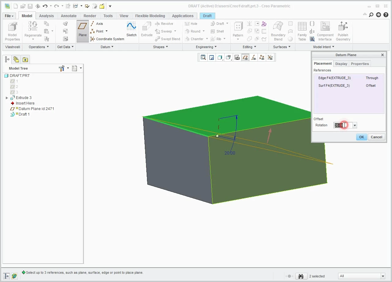

Create your Draft feature for more than 30 degrees

Why do you need to go through so many steps to draft greater than 30deg?  The draft function should allow you to do this without the "clever" workaround.

Hi Hugo and Michael,
If you need to create Draft feature - you can set max/min 30deg.
In this video you can see How you can set another option for Draw feature.
If you ask my: it is possible create "smarter" feature? - my answer is: YES = you can use PTC Creo Flexible Modeling and MOVE feature - it is much powerfull, and you can set any degree for your drafted surface (if you create draft with MOVE feature)
Note: I like PTC products and they best solution for my design with Creo Parametric and ProE
March 19, 2013
... and here you can find more info -  Tip of the Month : Flexible Modeling for you
