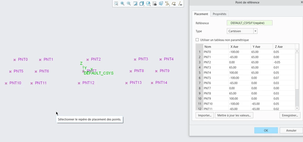

I have multiple points like this :

One method would be to create straight curve through each point to form the grid.
Then if you need surfaces use a boundary blend to create flats on each segment. A little time consuming but it should work.

I had the same response to the problem that @Michael suggests. You might not even need the surfaces, if you're not going to be making any shaded images of the data. Besides, the four-sided surfaces won't really be very accurate as a representation of the "actual" surface you are measuring, will they?
If you've got lots and lots of points and the tedium is going to be too painful, you might want to look into external software that will turn this kind of data (a "point cloud") into facets. This kind of problem comes up a lot with topographical data, laser inspection systems, and the like.
If you're really ambitious, and the data is in a nice grid, you might be able to edit a copy of the points to build a suitable importable geometry file, like IGES or STEP, with the linear curves defined already. Or a program could be written to use the points to build the curves, etc.

If you are not familiar with .ibl file format, look into that format to generate the curves from the points. When importing the .ibl format it will produce curves in Creo. Be advised that these curves are not native features so are not parametric features but it seems like this would not be an issue for your scenario.
How to import .ibl files.
https://www.ptc.com/en/support/article/CS107337
This is an example of the .ibl file syntax. You can create them in a text editor using the points from your metrology report.

Based on the photo of the report and the graphic shown there; The .ibl approach would use 10 curves defined in the file. The .ibl file does not define surfaces, only curves. Using 10 curves defined within the .ibl format can generate the same grid view shown in the photo.

You can’t create a surface through this 4 curves?
If the curves are line segments and not splines the surfaces would be created automatically as far I remember.
You have the same number of points for each curve, so this should be easy. This is what Michael mentioned!
