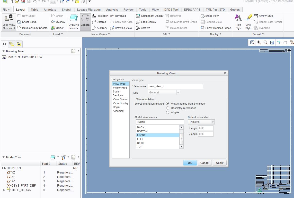

Hi..
I want to create general view for orientation of TOP_VIEW ( drawing solid orientation) but getting difficulty to pass matrix.
i am creating general drawing view by below API.
status = ProDrawingGeneralviewCreate (p_drawing, (ProSolid)comp_mdl, 2, PRO_B_FALSE, pos, 0.2, matrix2, &view);
it gives me error due to matrix, So please can anybody suggest me how to pass matrix from drawing solid orientation ( TOP_VIEW).
If any sample code is there then it is better to create general drawing view from drawing solid view orientation.

I just want to create general drawing view from model view
e.g. from front end we create general drawing view from RMB on screen and say insert general view then select orientation method as view name from model and select model view name (FRONT /TOP/ RIGHT /LEFT etc.)

To place a drawing view using a model view, you will need to get the orientation matrix of that particular view. Take a look at ProView object.
One possible way to do it is to use "ProViewNameToView" function to initialize the model view. Once you have the view handle use "ProViewMatrixGet" to extract the orientation matrix.
You need to work with multiple matrices and, as Mark Stallard‌ already mentioned, this is something that is not documented well enough.

I tried with given way by extracting orientation by "ProViewMatrixGet" and passing it in to "ProDrawingGeneralviewCreate" but it gives me general error (- 1) after run the application.
