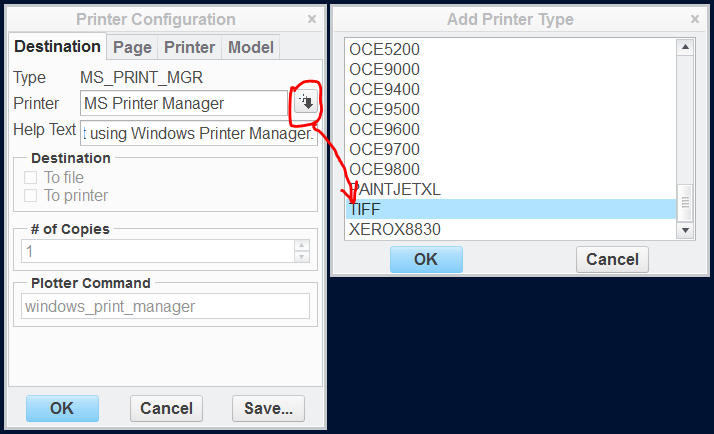

Vladimir,
in CR2 you set raster_plot_dpi config.pro option. Unfortunatelly its max value is 400dpi. Then you can print to TIFF printer.

Vladimir,
MH

September 21, 2015
Thanks Martin,
400 dpi is quiet good for now, thanks ... maybe in the future it will be not enough but seems that will be fine.
