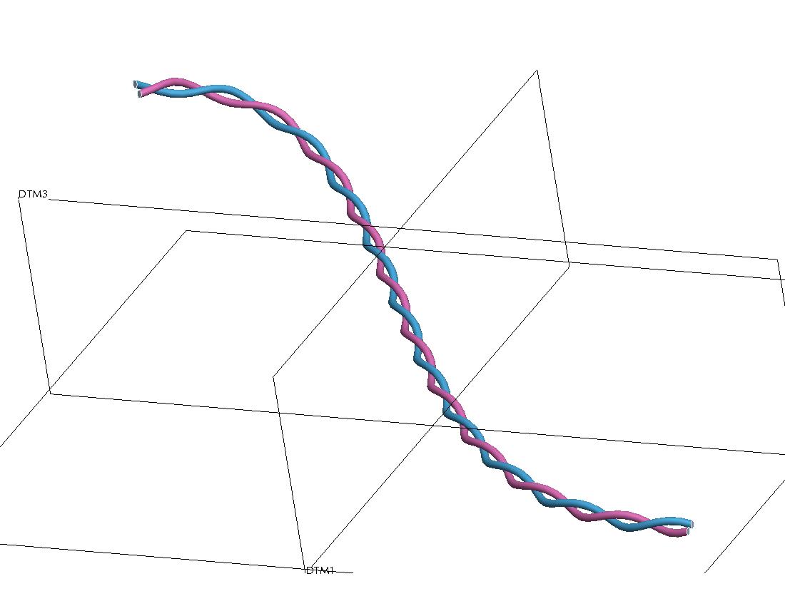

Can anyone tell me how to show twisted wires in Pro-E? I took the PTC training course on Cabling a few years ago and the instructor couldnt show me then. Does anyone know how to do this now. I'm using 4.0 now.

Are you trying to do this within Cabling automatically, or do you want a general modeling method? I don't remember this being an automatic feature when I last looked at the Cabling module a few years back, I may be wrong. Anyway, it can be done quite easily with a Datum Curve at the centerline of your cable and two (or more) Variable Section Sweeps twisting around the Curve for the individual wires.
When you create the VSS, you sketch a circle on an angled centerline going through the start point, then you vary the angle dimension using a Relation in Sketcher. For example, if you wanted 10 twists as in the above illustration, your relation would be something like sd4=trajpar*360*10.

P.S. This general method can be used for a variety of different things, such as twisted cable, or even a twisted-three-wire spring:
