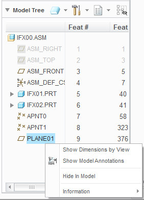

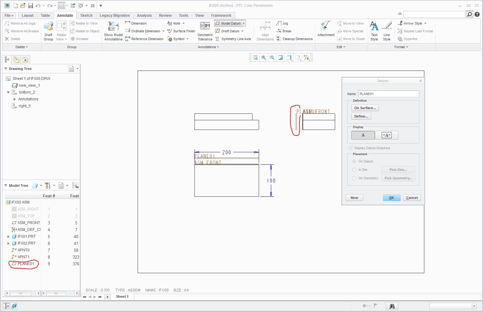

September 1, 2015
Kathryn,
I created new model datum plane in Drawing mode, see following pictures.
To delete PLANE01, I had to open an assembly in separate window (in Assembly mode).
Martin Hanak
