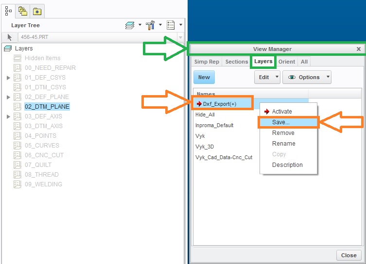

Deletion of layers in creo drawing to create .dxf file.

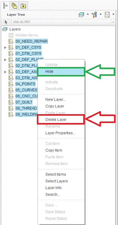

Hello Gopinath N
in generall:
1) Delete layers in order to export DXF file isn´t good idea.
    Press RMB on desired layer and pop-up menu will appears.
2) Much better is HIDE desired layers and SAVE layers status in View manager
    ( + ) - behinde layers means, that layers has been changed and HASNˇT BEEN SAVED
    click RMB on layer and press SAVE

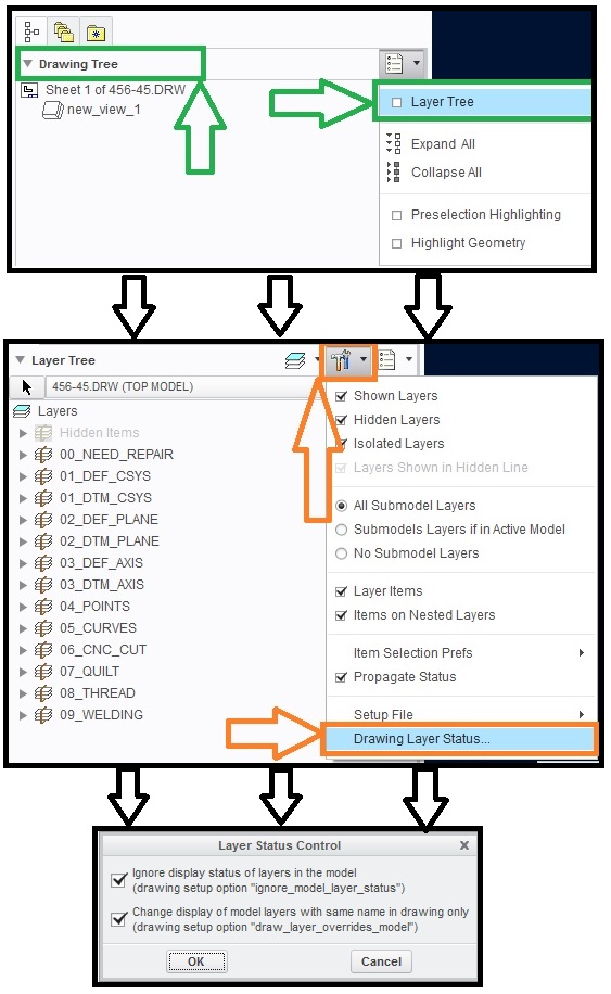

Note:
From my praxis it´s much better to make drawing layers and graphics area layers independent. See following picture.
Hope it can helps
