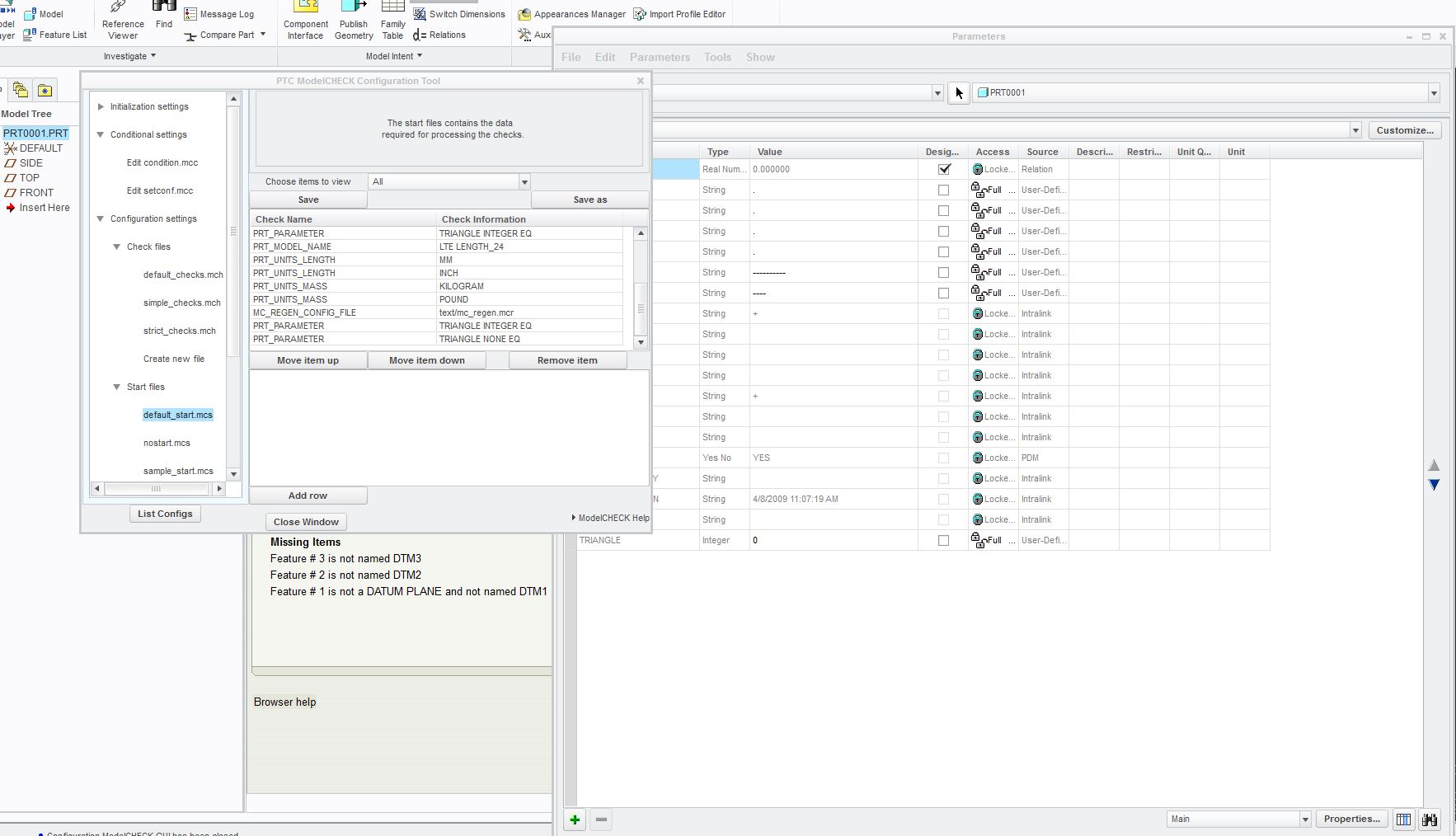

According to image value in ModelCHECK parameter is missing, add PDM as value for parameters. e.g. PRT_PARAMETER TRIANGLE NONE EQ PDM

You may try using <MODE>_PARAMETER <PARAM> <TYPE> <FUNCTION> PDM (e.g. PRT_PARAMETER DESCRIPTION NONE EQ PDM) in start file
Mar 4, 2015 10:02 AM UTC
Hi
I have tried the above method but unable to achieve the desire thing.
Kindly find the attached image
Mahesh_Sharma
22-Sapphire I
Mar 4, 2015 3:58 PM UTC

Haris,
Does the syntax help you to designate parameter?
Mar 10, 2015 4:45 PM UTC
Yes.Now I can able to designate
Thanks a lot...

Hello, I'm strugeling with modelcheck (Creo3.0M110)
I added  lines in the file to check like below:
PRT_PARAMETER NAME_1 NONE EQ PDM
PRT_PARAMETER NAME_2 NONE EQ PDM
PRT_PARAMETER DRAWING_REVISION STR EQ LIST_PRT_REV
PRT_PARAMETER PRODUCT_MODEL STR EQ LIST_PRODUCT_MODEL

All parameters are added except the ones with "NONE EQ PDM"
PTC ModelCHECK
PARAMCHECK
   Error updating parameter(s): 3
    FLS_DESCRIPTION
    NAME_1
    NAME_2
