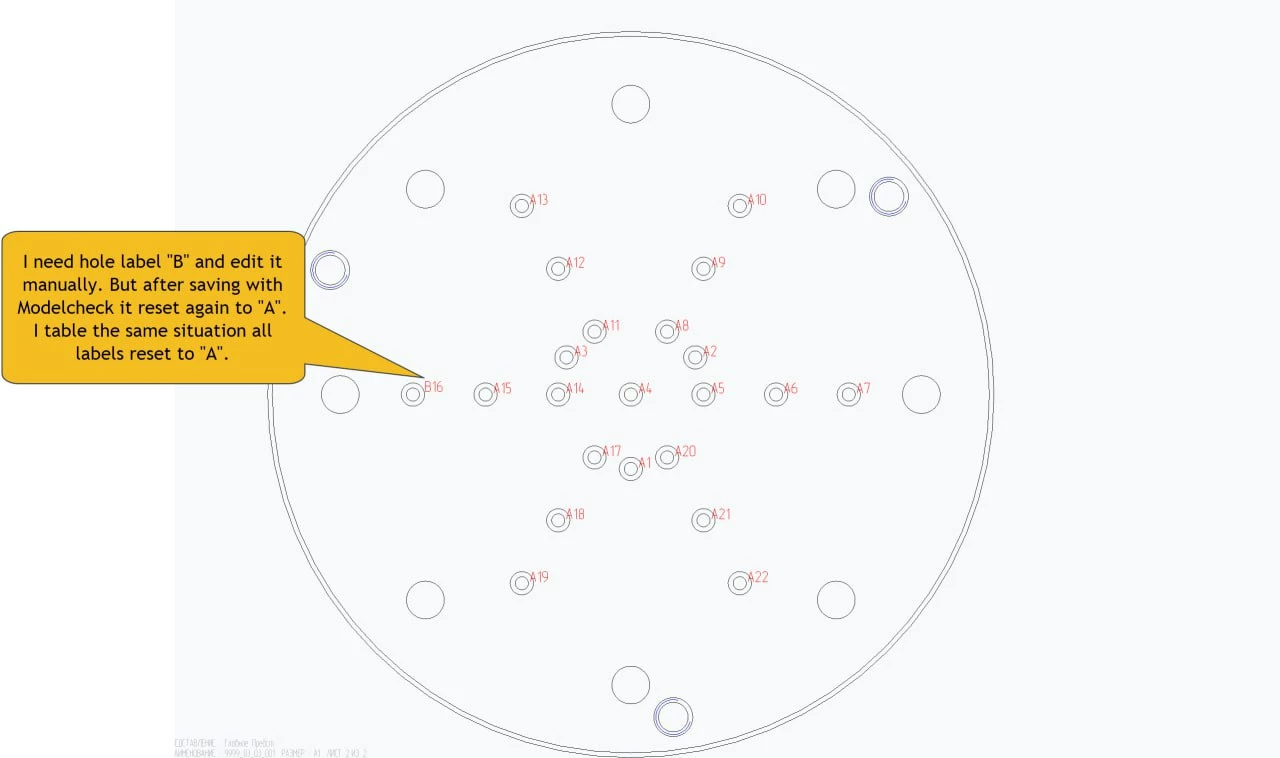

Hello. I need to make hole tables on two different sheets of the drawing. Moreover, on the second sheet the numbering of the hole labels should continues, and does not start from the beginning. I already understood that it is impossible to do this in Creo. So, I want manually edit table and labels on second sheet. However, when Save drawing with Modelcheck, all my edits are reset. For example, I change the name of the tag, after I click Save with modelcheck, the label value returns to the original. Maybe someone knows where in Modelcheck settings I can disable this automatic update of tables and hole labels?

The question is still actual. I'll glad if exist any way to save manual edits in hole tables of drawing. Even if I not need to edit labels. For example I need to add row, or add tolerance to dimvalues. All of these are reset after regeneration model.
Here says that it possible to add tolerance manually (it suitable for creo 1.0-10.0) without updating table. But hole table automatically updates when I regenerate model. In creo 6 manually edits saves, but in creo 10 - no.
