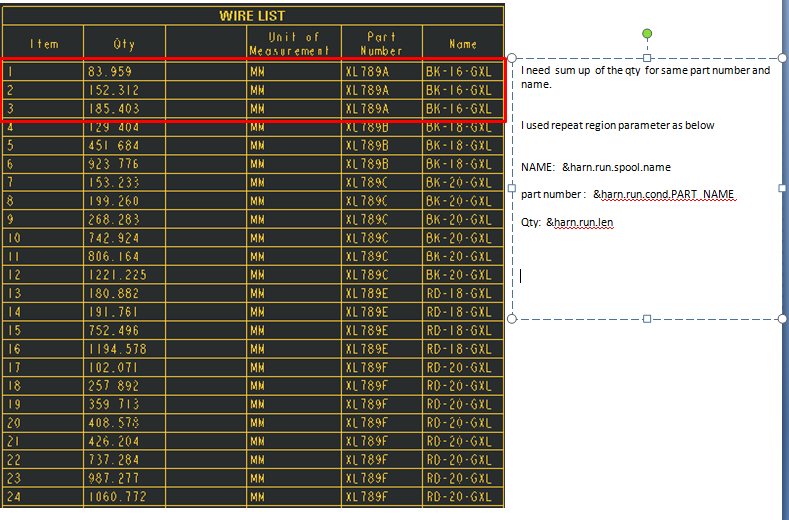

I know how to sum the whole table qty. But all I need to know is how to sum  up the qty for each part number in the table.
As in the pic,  I need to calculate the sum for “BK-16-GXL”   in the qty coloumn .I've attached a snap for ur reference...KIndly help me
do i need to use any relation or modify repeat region options ? Let me know

Go to TABLE - REPEAT REGION - ATTRIBUTES - NO DUP/LEVEL

thank u for ur reply stephens... @stephens williams
in repeat region there is a option to add the total quantity by "SUMMATION"
In that we can add the total quantity and get the answer in single cell.
but i want to add seperately for each color
for example
i want to sum up "BK-16-GXL"  qty as 83.95+152.312+185.403 in a seperate cell...

If summation works then maybe you should just do multiple repeat regions for each part with a filter.

but if u never mind...could u please explain elaborately... i cant understand plzzz
