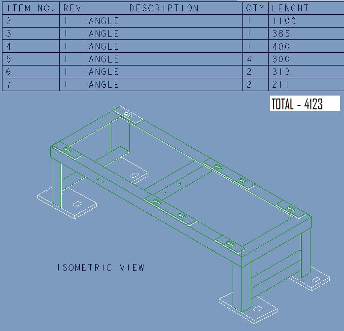

the lenght in table is driven by parameters..
i use relation in assembly to add all the lenght parameters
and is working fine but...
now, i need to add two new angles in this assembly and i want automated addition of length by the time i add them up in assembly.
is it possible? or any solution plz share

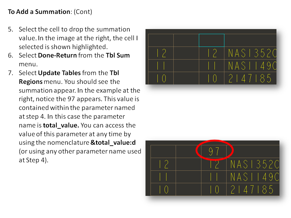

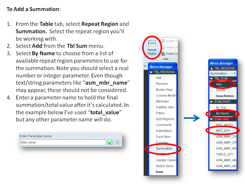

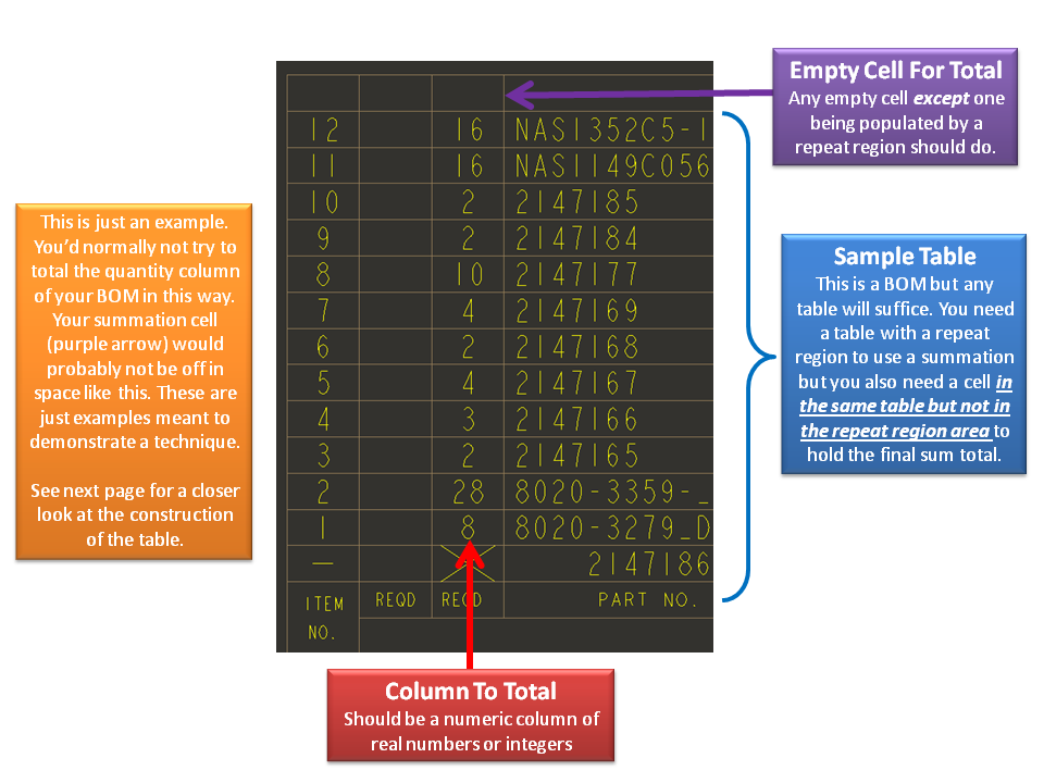

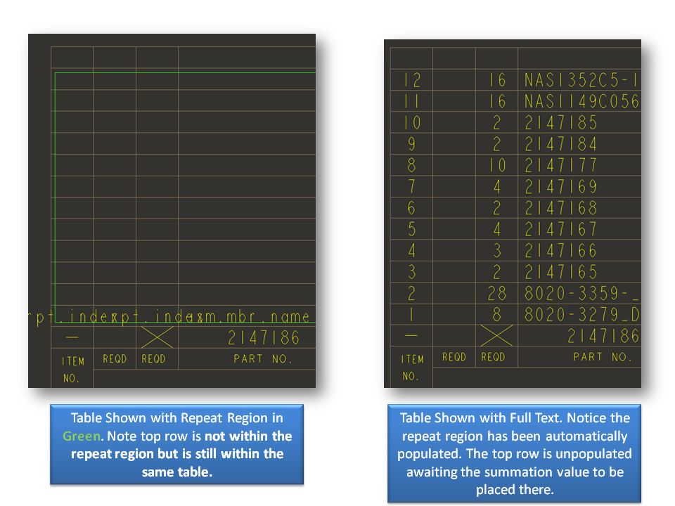

Hi Dalbeer...
Not my usual quality but it's 5:30am and I haven't slept! I hope this gets the point across. Write back if this doesn't make sense.
I really, really hope that makes sense. The Summation tool is useful but rarely used because it has some idiosyncrasies that need to be heeded for the function to work. This should be what you're looking for. Good luck!
Thanks!
-Brian
