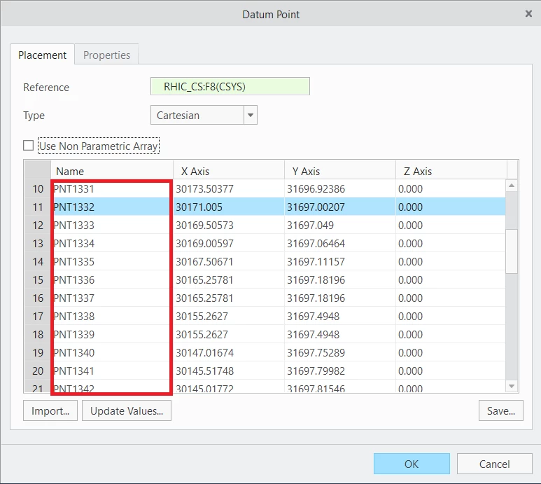

When importing thousands of points from an excell sheet, Creo assigns random names to them.
Is there a way to copy and paste the points' names from the excell sheet? (Instead of renaming them one by one )
Or alternatively use a script?

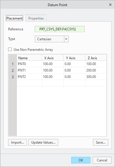

unfortunately I do not see any easy solution. This is because point names shown in dialog box are not visible in model tree - they are hidden inside datum point feature (this feature contains points offset from coordinate system).
Option no.1 ... generate mapkey (if I were you I would develop simple program, which generates mapkey code specific for current situation)
I tested this option in Creo 7.0 ... see below.
Names before modification
Names after modification

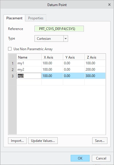

mapkey ss \
mapkey(continued) ~ Select `Odui_Dlg_00` `t1.CSysPntsTbl` 2 `okit_wdg_table_row_0` `Name`;\
mapkey(continued) ~ RButtonArm `Odui_Dlg_00` `t1.CSysPntsTbl` 2 `okit_wdg_table_row_0` `Name`;\
mapkey(continued) ~ PopupOver `Odui_Dlg_00` `t1.pnts_table` 1 `t1.CSysPntsTbl`;\
mapkey(continued) ~ Open `Odui_Dlg_00` `t1.pnts_table`;~ Close `Odui_Dlg_00` `t1.pnts_table`;\
mapkey(continued) ~ Activate `Odui_Dlg_00` `t1.rename`;\
mapkey(continued) ~ Update `Odui_Dlg_00` `t1.PntNameInpPnl` `my1`;\
mapkey(continued) ~ Select `Odui_Dlg_00` `t1.CSysPntsTbl` 2 `okit_wdg_table_row_1` `Name`;\
mapkey(continued) ~ RButtonArm `Odui_Dlg_00` `t1.CSysPntsTbl` 2 `okit_wdg_table_row_1` `Name`;\
mapkey(continued) ~ Update `Odui_Dlg_00` `t1.PntNameInpPnl` `my2`;\
mapkey(continued) ~ Select `Odui_Dlg_00` `t1.CSysPntsTbl` 2 `okit_wdg_table_row_2` `Name`;\
mapkey(continued) ~ RButtonArm `Odui_Dlg_00` `t1.CSysPntsTbl` 2 `okit_wdg_table_row_2` `Name`;\
mapkey(continued) ~ Update `Odui_Dlg_00` `t1.PntNameInpPnl` `my3`;\
okit_wdg_table_row_0 ... 1st table row
okit_wdg_table_row_1 ... 2nd table row
okit_wdg_table_row_2 ... 3rd table row
my1, my2, my3 ... new point names

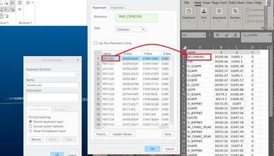

Thanks Martin, using Mapkeys is a brilliant idea. I can see how this would work. opened the datum points edit window and the excel sheet side by side and recorded a mapkey to copy and paste the cell value.
The difficult part is to automate the task to run down the table and copy/paste all the cells.

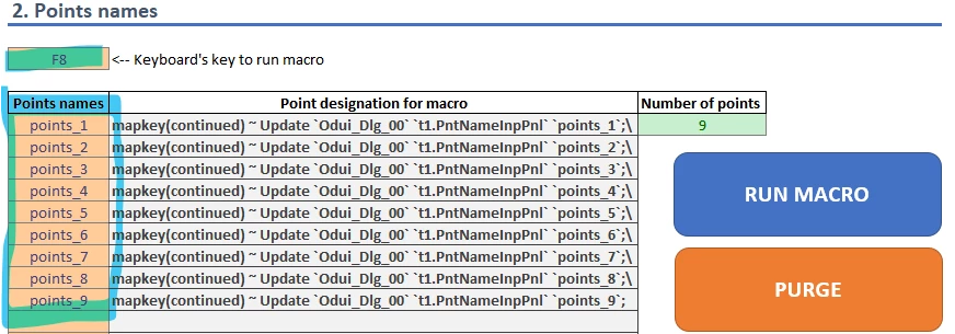

I joined an Excel file whom create the desired macro to rename points. I developed it to rename points from dots scans.
It's based on Martin method describe above (datum points functions) and extended to the required number of points (up to 1000 points).
Under 2nd chapter, just choose a key to run the macro within Creo, give points names into orange cells and click on "run macro"
The macro is copied into clipboard, to be pasted into your config file.
Edit the datum points function and run the macro
