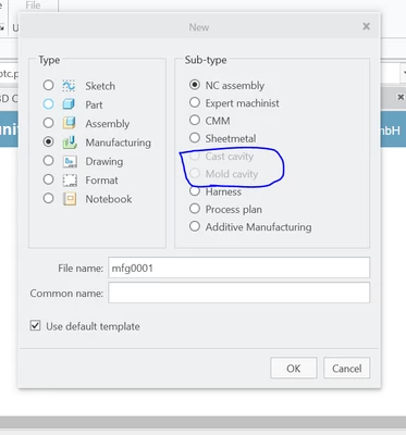

how to enable an option of mold cavity in sub type in creo 9.0
how to enable this option in creo9.0

You need to have a mold design module license to access the mold and casting subtypes.
