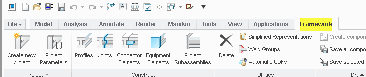

It's an assembly function so you have to be in an assembly (not a part).
There is a Framework tab.

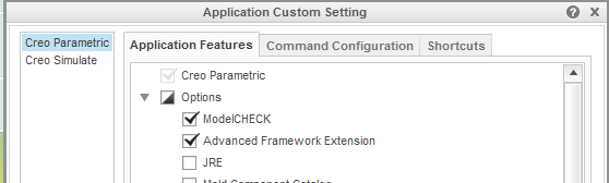

You have to make sure it's checked to be installed?

Hello Pedro,
Were you able to access AFX, via the suggestions above?

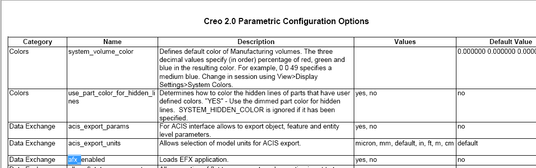

Almost forgot you need this in the config.pro.
afx_enabled yes

I was looking at mine, I don't have that option set. By default, AFX is enabled. Only if it was specifically disabled (afx_enable is specifically set to NO in the config.pro) would you need to change it.
January 31, 2017
Ah.  I forgot this post is for Creo 3.  I am still on Creo 2 and the default is no.
