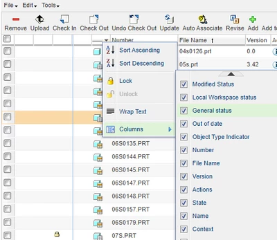

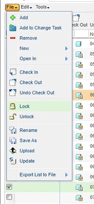

How to enable lock file and unlock file in my creo file window
In my creo's manage file window lock file or unlock file option is not available. is there any configuration setting needs to be changed for that??
7 replies
StephenW
Nov 28, 2023 11:18 AM UTC
I think you are referring to File - Manage File - Lock. I am not 100% sure but I believe this is only available for users of Windchill PDMLink.
7-Bedrock
Nov 28, 2023 12:21 PM UTC
You're right, In my wind-chill workspace i am not able to see this lock option. Is there any settings to be changed for that?
kdirth
Nov 28, 2023 1:57 PM UTC

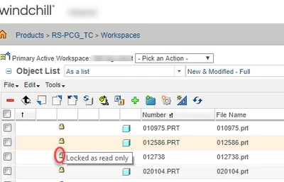

In windchill, select the file/files then File > Lock
If the column is not visible, select the dropdown for a column then the columns and check General status.
