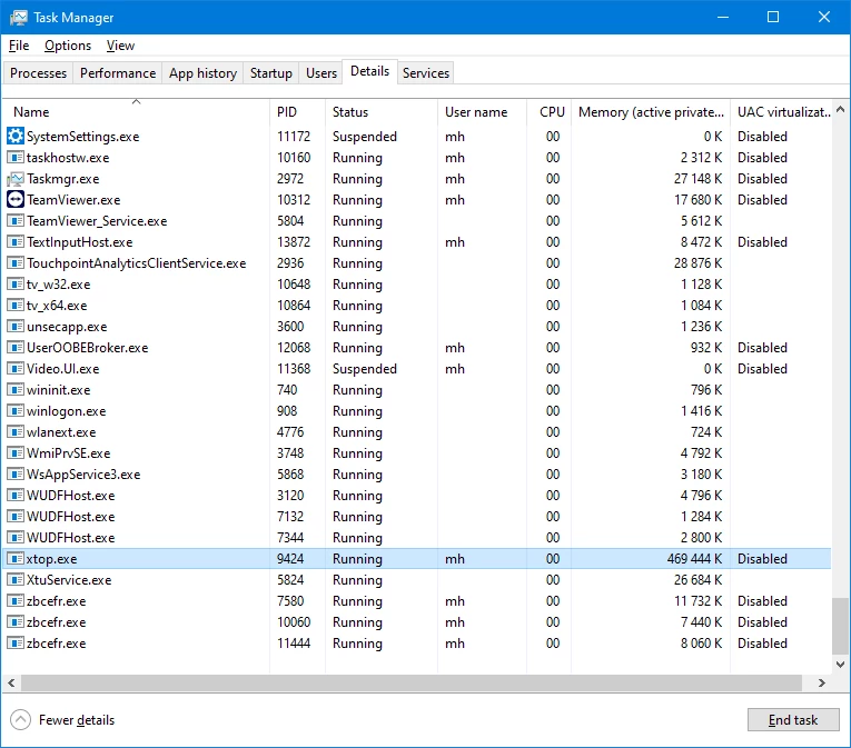

in Task Manager:
  • check how much RAM is allocated for xtop.exe process
    • add RAM if Creo has exhausted it
  • check processor load
    • many operations are single threaded ... so use Set affinity command to assign single core to xtop.exe process
    • if the core runs at 100% then the only possibility to accelerate Creo is processor overclocking

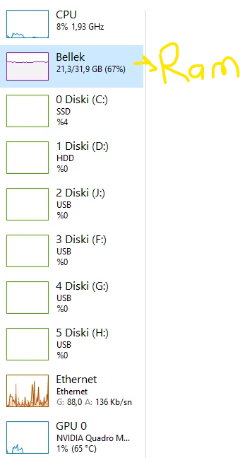

Hi
I checked the performance monitor. Seems like Creo is using 1/4 RAM of computer. I have 32 GB RAM and Creo Uses 8GB. So I think its normal.
Also i set priority for Creo. Maybe it will help.
And is it possible to change settings in Creo for performance ?
-Enes

Look at xtop.exe process.
Also check processor load in CPU column.
