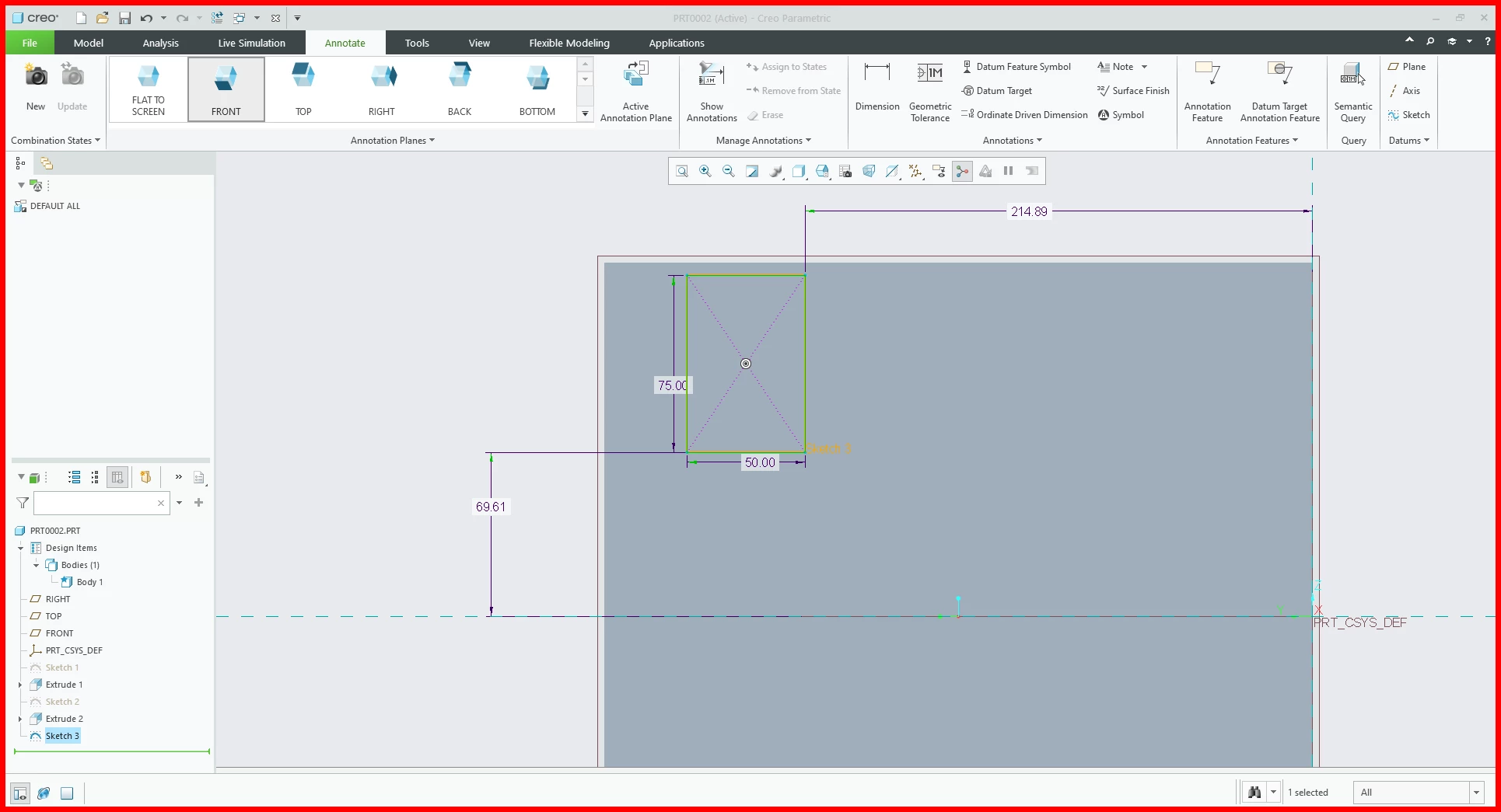

I've been working extensively in PTC Creo Parametric's sketching environment and wanted to share some thoughts on ensuring your 2D sketches are fully defined. Additionally, I'd like to seek your insights on managing weak dimensions, particularly when it comes to deleting or modifying them.
#### Dealing with Weak Constraints and Dimensions
I've been encountering an issue with weak constraints, particularly dimensions that Creo automatically sets. For example, I have a weak dimension set at 69.61, and I'm having trouble deleting it. I wish to set this dimension to 5, measuring from the top gray edge to the top yellow line.
- **Is it possible to delete weak dimensions that Creo automatically sets?**
- **How can I change this weak dimension to a strong one and set it to 5?**
- **Is there a reference starting point for these weak dimensions that I should be aware of?**

You goal should be to not have weak dimensions in your sketches. The dimensions in your sketches and features should capture design intent which is the best way to leverage the functionality of a parametric CAD system.
Select your sketch plane and your sketch references in the context of design intent. By setting the references you can leverage the intent manager to some extent to minimize creating new dimensions when sketching. Exploit constraints and construction geometry within sketcher to minimize the number of explicit dimensions required to fully constrain a sketch.

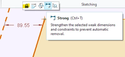

- **Is it possible to delete weak dimensions that Creo automatically sets?**  Creo maintains a fully constrained sketch at all times.  The weak dimension created will be removed when you add your own dimension that eliminates the need for that weak dimension.
- **How can I change this weak dimension to a strong one and set it to 5?**  If you double click on the weak dimension and enter a new number, it will change to a strong dimension.  You can also select the dimension and make it strong by selecting the icon in the mini tool bar.  You can also select the lock to lock the dimensions.  I prefer to lock most dimensions because this prevents dragging of the dimension or entity in that direction.  I also use config "sketcher_lock_modified_dims yes" to automatically lock modified dimensions.
- **Is there a reference starting point for these weak dimensions that I should be aware of?**  As @tbraxton indicated, the references set in the sketch will be used to contstain the sketch.  Preselecting the desired references will help Creo create appropriate dimensions that can then be modified.  Teh order in which you draw entities will also have some effect on what Creo creates.
