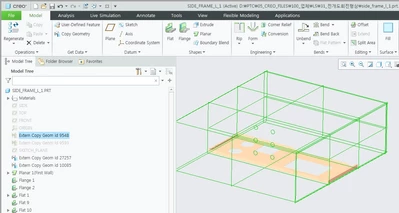

How to exclude a Copy External Geometry feature from view?
There are hidden external geometry copy data as pictured.

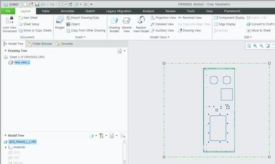

That hidden feature leaves the view blank.
Is it possible to prevent the hidden state of external features from appearing in the view of the drawing other than a simplified representation?

Jul 19, 2022 12:04 PM UTC
Unhide the layer it is on in the drawing or remove it from the layer if it does not need to be hidden in the model.
