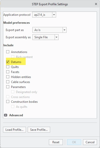

If the datum option in the export filter is not active, try turning that on and report back. I would also use the ap214_is protocol as shown below.

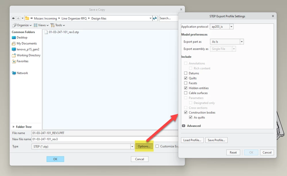

Hi, I don't seem to have that menu when I have been saving as a STEP file. I have been saving the file as a copy with the file extension set to .stp, is there some other way I should be exporting to get these options?
tbraxton
Feb 8, 2024 2:48 PM UTC
File->Save as -> Save a copy

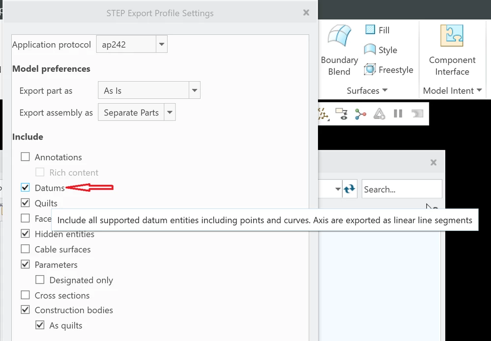

Don't use cosmetic sketches, they're total garbage for a number of reasons.  Use a datum curve instead, and that should output if you have the "Datums" checked.

I can confirm that it is possible to export a cosmetic sketch to a STEP file from within Creo. I have done it multiple times this week using the method I posted above.
Feb 15, 2024 3:00 PM UTC
Make sure your cosmetic sketch layer is not hidden (you can check it thru view >> layers)
And then try to save as step, with settings that @tbraxton mentioned,
It should be including cosmetic sketch into step file
