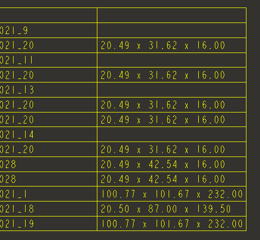

If all you want to do is view the values of the overall size of the items, then create a table on a drawing of the assembly with a repeat region and use asm... mbr... then User Defined and enter mc_size
This will list, in one cell on your table the size of the models.
If you want to split it out into x y and z components it will become a little more complicated!
e.g.
