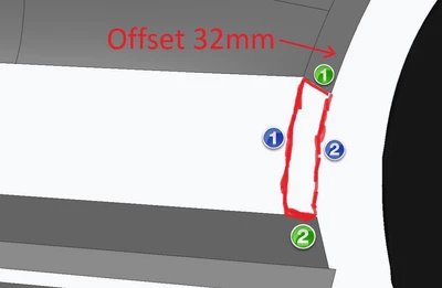

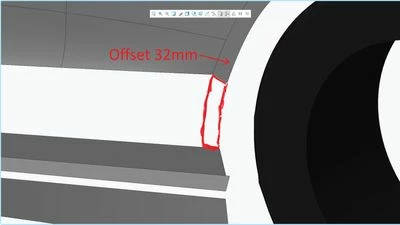

Hello. I'm creating a car in Creo Parametric 9.0. I'm currently modeling a wheel arch and need help. I don't know how to connect the arch to another surface. Here's a screenshot to help you understand what I mean:

Using core surfacing tools, a boundary blend should work. You will be able to control the surface connections with the boundary blend feature. You will likely need this control to get what you want and extend will not allow this control.
https://support.ptc.com/help/creo/creo_pma/r11.0/usascii/index.html#page/surfacing/surface/To_Create_a_Boundary_Blend_in_Two_Directions.html#
You will need to create 3D curves for the long edges of the 4 sided surface. Use the existing edges of the surfaces (green) for one direction and your new curves for the second direction (blue).

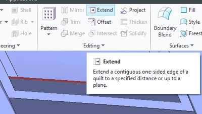

Can you just use the "EXTEND" Command such that it intersects the other surface and then MERGE the two quilts together?
Maskalex10-MarbleAuthor
Sep 22, 2025 3:44 PM UTC
Where the "Extend" command is located?
kdirth
Sep 22, 2025 3:53 PM UTC
Select the edge of the surface to enable the command found in Editing section of ribbon.
