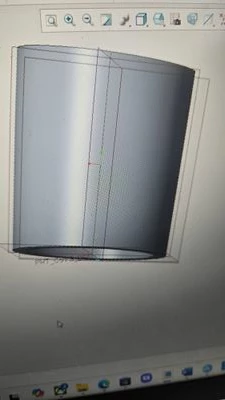

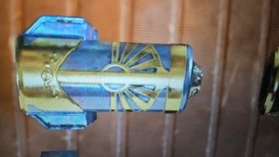

How would I add this design to the curved surface of a cylinder? (Creo 8.0)

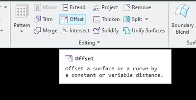

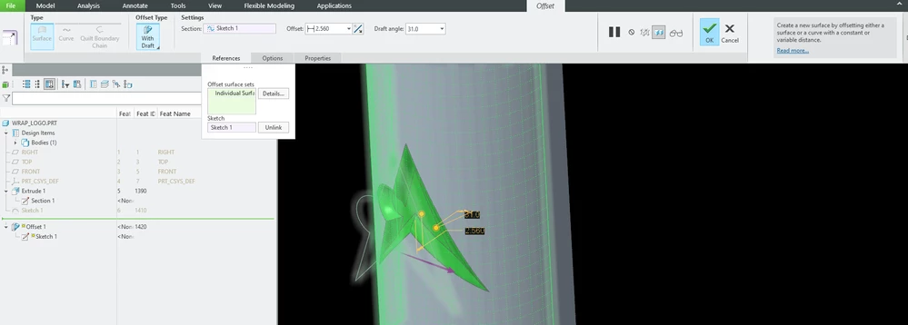

Maybe you can use the Offset "with Draft" function:
