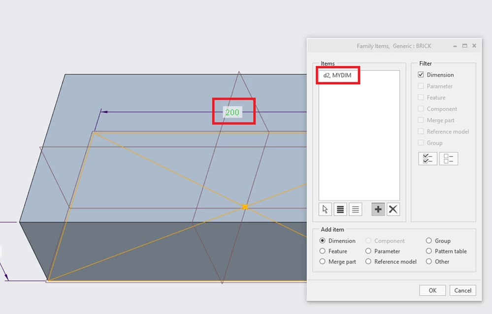

I've got a part with two dims that I've renamed from their original symbolic names (example: d123) to C and D.  How do I find their original dimension names if I've forgotten what they were?
Jul 3, 2025 10:12 AM UTC
start creating family table and select a dimension ... see picture.

I love these workarounds!  Logical yet unintuitive!
