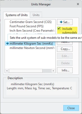

I am not aware of a system parameter that is searchable for units set in a model.
The most expedient fix for this is to force consistent units in the top level assembly model.
Use the following command sequence.
File > Prepare > Model Properties > Units > Change >Include Submodels > Set
Jul 14, 2023 2:21 PM UTC
This fixes everything.  Thank you all models are correctly scaled.

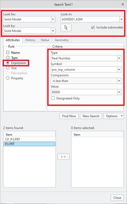

Jul 14, 2023 7:16 AM UTC
maybe because of English units the volume of English models is "small".
You can use something like this:
