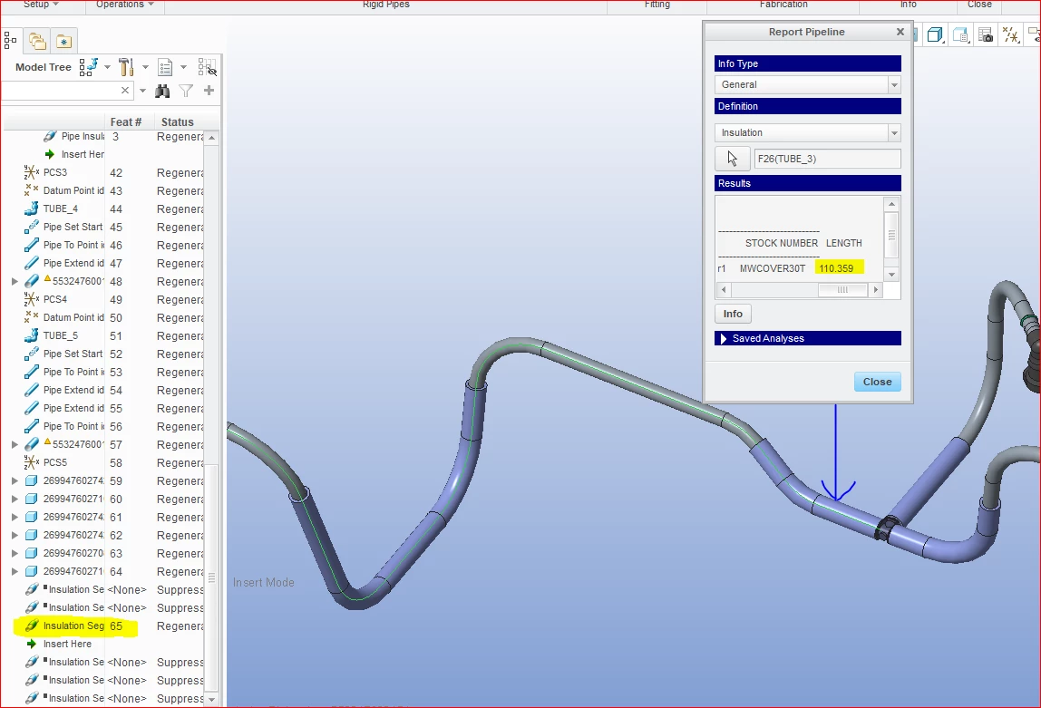

I want to do one correction in my question that how to find each insulation length in pipe ?
Piping Info > Change definition to Insulation > Select Pipeline > result will provide length
I have number of insulation in one pipe and the above option gives me total insulation length instead of each insulation.
So I want to know the each separate insulation length in pipe. so please can you help me.
Prashant Pandarkar
Jun 17, 2019 3:20 AM UTC
Please suppress all other insulation features except for which you want to measure length and measure insulation length by same way.

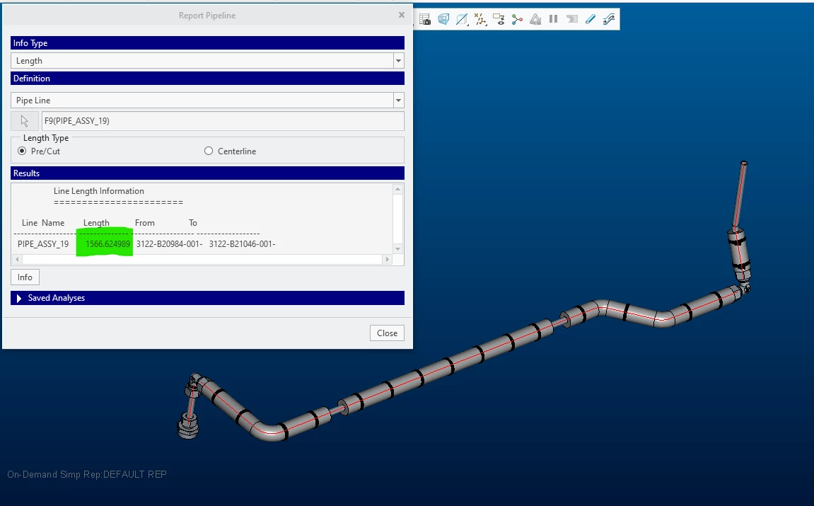

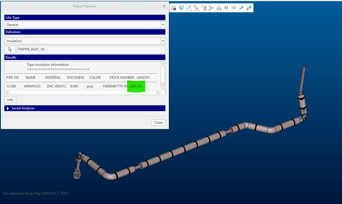

Sorry for the follow up here, but I got a related issue with the insulation total length in Piping Info.
The indicated length of 2484.655 is not matching with the computed sum of lengths of the single insulation segments (.1189.5mm using the method stated here).
Surprisingly,  it is bigger than the all pipeline length (see 2nd screenshot)!
Anyone able to clarify this please?
